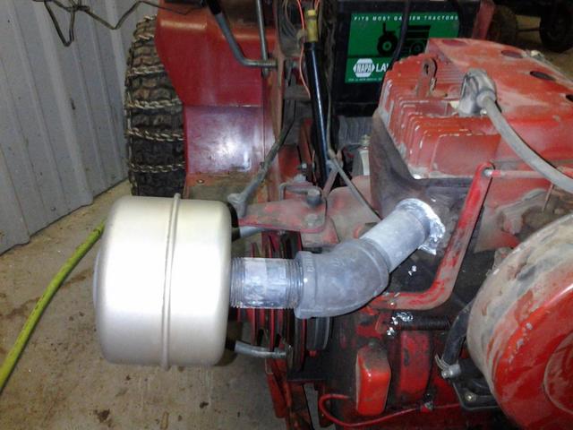

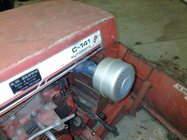

56flatbed 29 #22 Posted December 2, 2013 cjsdad, I had the same muffler on my C-141 until it finally burned/rusted through and melted the air filter element. It had also melted the headlight wiring sometime in the past. I tried the stack type muffler, twice. Too many problems with vibration breaking welds, and low hanging branches. I ended up using an Arnold #35-006 muffler (cheap and available everywhere) and some 1" pipe. Remove your old muffler and unthread the pipe from the engine. I used a 3" long pipe on the engine, to a 45* elbow, a 2" section of pipe and then the muffler. Use anti-seize on all the threads. The muffler ends up being straight out from the engine and clears the hood. All for less than $13.00. Wally Share this post Link to post Share on other sites
Knucklebuster61 0 #23 Posted December 2, 2013 cjsdad, I had the same muffler on my C-141 until it finally burned/rusted through and melted the air filter element. It had also melted the headlight wiring sometime in the past. I tried the stack type muffler, twice. Too many problems with vibration breaking welds, and low hanging branches. I ended up using an Arnold #35-006 muffler (cheap and available everywhere) and some 1" pipe. Remove your old muffler and unthread the pipe from the engine. I used a 3" long pipe on the engine, to a 45* elbow, a 2" section of pipe and then the muffler. Use anti-seize on all the threads. The muffler ends up being straight out from the engine and clears the hood. All for less than $13.00. Wally Nice setup, Flatbed. I wonder what the noise factor is? I have the same exact setup as the original poster and think (personally) that this has gone a bit far. I have NO ISSUES with my exhaust and tend to think that it all goes back to tuning your engine/carb setup (maybe). As I stated previously, I think my factory muffler is on its way out due to rattling noises I hear when running my C-125 and cannot pinpoint nor find anything loose. I believe my sounds are coming from inside the muffler. Don't really want to put a stack on so I think I may take your lead on mine. I still wish cjsdad the best of luck in solving his issue. Sucks when the machines get the best of us. Believe me; I know. Share this post Link to post Share on other sites
Knucklebuster61 0 #24 Posted December 2, 2013 (edited) How did you thread that muffler on, Flatbed? When I Google it, I find them on Amazon for 4 bucks. But it looks like they have a threaded pipe coming out of them and it looks like a lawn mower muffler; says it's for 4 to 8 HP engines. Looks like yours has an inside thread and you said you have a 1" pipe going into it. So I'm confused. As I said, my setup is the same as CJSDAD's. See Photo. Edited December 2, 2013 by Knucklebuster61 Share this post Link to post Share on other sites
56flatbed 29 #25 Posted December 2, 2013 Knucklebuster, there is a 1" female pipe thread on the muffler. The noise is much less than the stack I had on it, but louder than my sons 312-8. Use hearing protection. Wally Share this post Link to post Share on other sites
