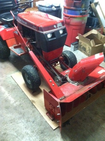

stnygrm 11 #1 Posted November 24, 2013 My 310-8 has 22x7.50x12 on it, what would be a good replacement for these since that size is hard to find chains for and too narrow! Thanks Share this post Link to post Share on other sites
Sparky-(Admin) 25,065 #2 Posted November 24, 2013 23x8.50x12 is probably the best size for your machine. You could go up to a 23x9.50x12 if your looking for a wide look. Mike......... Share this post Link to post Share on other sites
baerpath 517 #3 Posted November 24, 2013 I would look for 23 x 8.5 if you want to use your rims. I have a new set of 10.5 x 23 bar treads for sale on rims if interested I would look for 23 x 8.5 if you want to use your rims. I have a new set of 10.5 x 23 bar treads for sale on rims if interested Sparky types faster Share this post Link to post Share on other sites
stnygrm 11 #4 Posted November 24, 2013 would the deck need to be leveled if I go with 23 inch tires? Share this post Link to post Share on other sites
Irv 115 #5 Posted November 24, 2013 Probably a bit with the rod on the rear of the deck that has a nut on it-easy to do. Share this post Link to post Share on other sites
sorekiwi 761 #6 Posted November 24, 2013 These guys have a great selection of chains: https://www.cedarrapidstire.com/category/16328/2-link-tire-chains-rud-garden-tractor-tire-chains They have a 23-7.5x12 listed that I bet would fit. Call them up and ask, they were super helpful when I bought a set a few years ago - I was looking for a set for my B80 which I think has the 22-7.5 also. Share this post Link to post Share on other sites
Kelly 1,038 #7 Posted November 24, 2013 Also watch going to a bigger tire, some of the 300 series tractors with the small tires use a narrower rim, I have a 312 here with the 7.5 tires and it has 6" wide rims, wider tires will not fit very good on the narrow rim. Share this post Link to post Share on other sites
