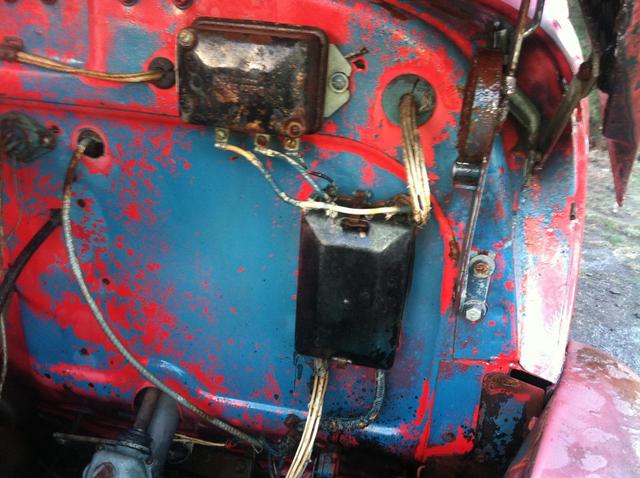

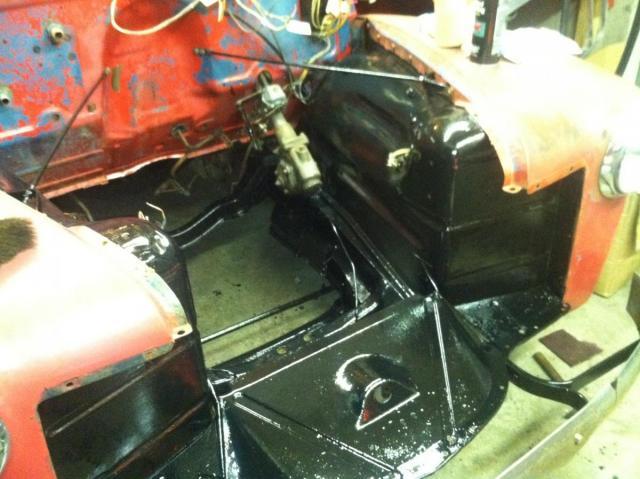

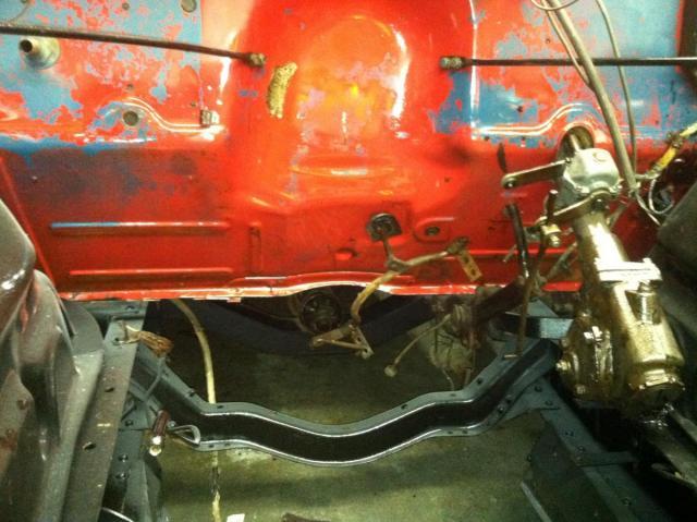

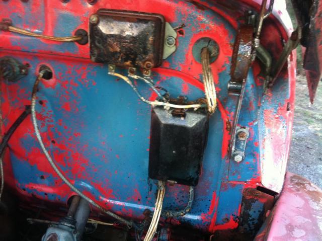

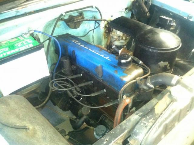

stevebo-(Moderator) 8,744 #76 Posted December 16, 2013 Just a quick update on this project. After discussing the rebuild of this motor (216ci) with my uncle who is an engine builder he convinced me not to touch that motor as it is not fully pressurized. He, along with others (Thanks Chip) told me to find a 235CI which is the updated version with fully pressurized motor. One of the guys who works for my uncle told me that his sone has one that is in his 56 Chevy 150 (bel air) that he was planning on pulling to install an LS motor. I went and saw it and heard her run so that is the one that will go in my truck. There will be a few mods and I will need to use my original tranny. The 56 is already upgraded to the 12volt so that means I will be updating the truck to 12 volt too. Did not plan on that but I have to now which will be better. The guy who has the new motor needs a month of two to pull it as he has a few other projects ahead of that. He also has a bodyshop so I may be able to work out a deal with him to clear coat the truck. The only thing I plan on doing to the motor is to replace the valve cover gasket, clean the motor and install it. I included a picture of the firewall below so you can see how the motor color will complement the engine color. I started to recover the seat. It was pretty beat but I got the frame cleaned up, primed and painted. This afternoon I went and got the new burlap and foam etc to start to recover it. I had to fix the backrest frame with 1x flatstock too. Below are pics of the new motor and seat. Slow and steady on this project. 2 Share this post Link to post Share on other sites

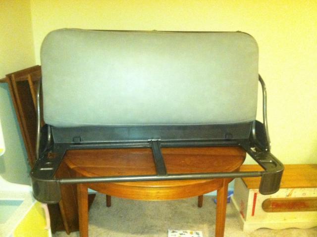

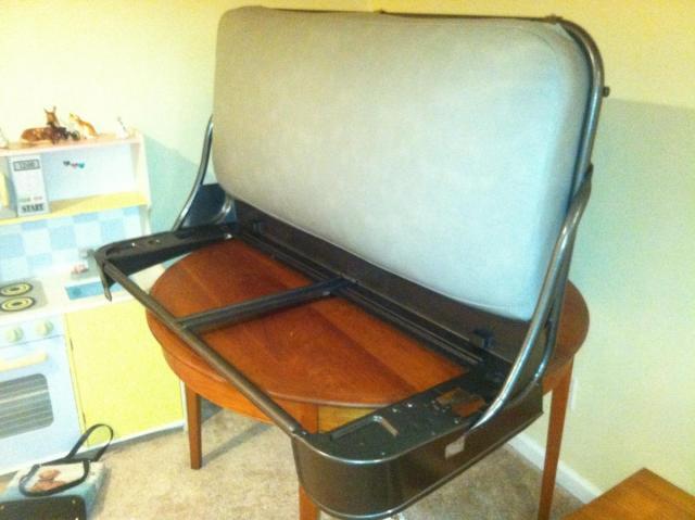

953 nut 70,452 #77 Posted December 16, 2013 Nice job on the seat. Always nice to be able to get a good running engine, saves a bunch of time and $. Share this post Link to post Share on other sites

stevebo-(Moderator) 8,744 #79 Posted December 16, 2013 From my understanding in my research here is what I have to do to make it work. The 56 tranny is not going to work for that reason. The truck has what is called a torque tube which is closed. I will need to use the starter and flywheel off the 235 with the 216 flywheel housing. I then need to use the 216 tranny and tailshaft. I have the tranny gearbox soaking in diesel right now. From what I could see it looked pretty good inside. The motor I am getting has 42K original miles on it. Before I install it I plan on painting inside the engine compartment and frame. I will also install new hard fuel line and brake lines too. They both look okay but with the motor out it will make it alot easier to do. Share this post Link to post Share on other sites

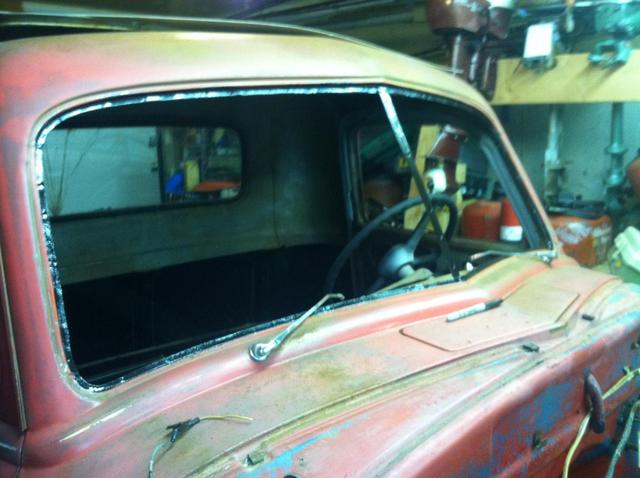

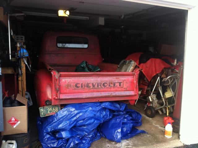

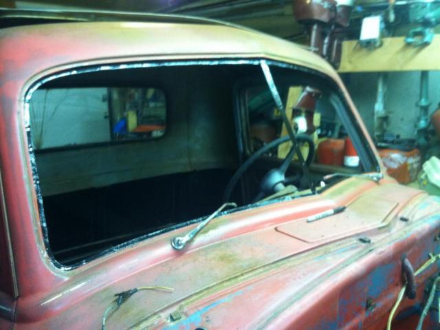

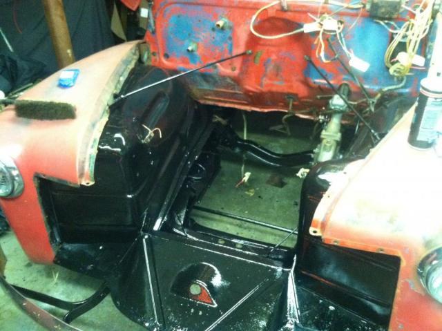

stevebo-(Moderator) 8,744 #88 Posted December 27, 2013 Here is an update on this project. It was just too cold to try and work on it out in the back yard and with the warm weather last week, the snow we had melted and I was able to pull it up the back hill and get her in the garage. Prior to going in the garage I took the be off and power washed everything really well again. Put the bed back on and got her in the garage. I have been working on the interior and rebuilding the two gauges and painting up the inside. I was able to paint inside the engine compartment while the motor is still out. I am now ready to drop in the new motor once it is ready to pick up. Pulled the front window and got the channel painted up too. I used chassis paint and a brush. I am not planning on this being any sort of show stopper. 1 Share this post Link to post Share on other sites
Ken B 3,203 #89 Posted December 27, 2013 Ain't no grass growin under yer feet! You must have had to do a little rearranging in the garage to be able to stuff Old Red in there! Share this post Link to post Share on other sites
stevebo-(Moderator) 8,744 #90 Posted December 27, 2013 You have a funny way of naming my trucks... I like it. I had to move one of the 35's to the barn and turn the other two sideways under the shelf but it made it. REAL tight. If all goes well this spring I may try and take the tractor shelves down and get the underside of the deck watertight and relocate the tractors out there or... get park "old red" under the deck? Not sure.... Share this post Link to post Share on other sites

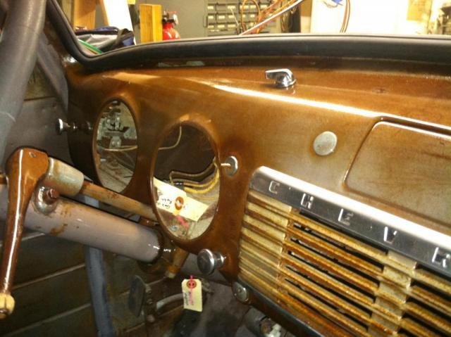

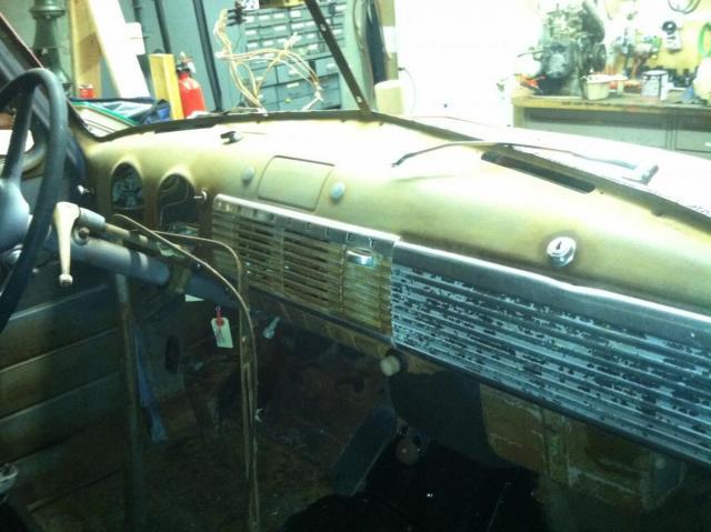

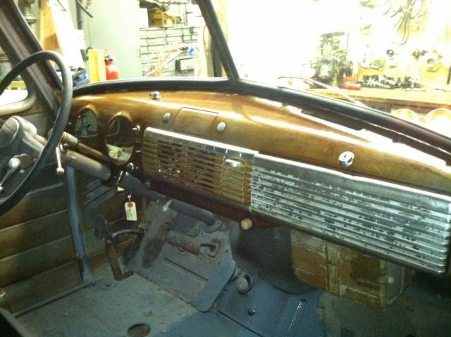

stevebo-(Moderator) 8,744 #92 Posted December 28, 2013 Just a few more pics of before and after on the interior dash and the bottom portion of the firewall. Got out the clear coat and sprayed away.... Share this post Link to post Share on other sites
posifour11 723 #93 Posted December 28, 2013 I'm a little different camp as far as preservation. My plan for the wife's truck ( formerly her granddad's) is to make sure it's mechanically sound, including a brake upgrade, and let her drive it and enjoy. Not much on the clear coat But, if you like it, I'm all for it. I figure, for my plans anyway, if her "papa"'s truck spent the last fifty plus years under an old cedar tree, it'll do fine under cover with my horses. Share this post Link to post Share on other sites

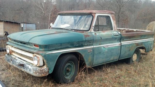

posifour11 723 #97 Posted December 28, 2013 Steve, I ran out and took a picture. Also did the math and its not quite fifty years old. Its a 66 Chevy short bed. Her grandpa bought to use for a farm truck and that's about all it was used for. Its on the list to do after about ten other things. 3 Share this post Link to post Share on other sites

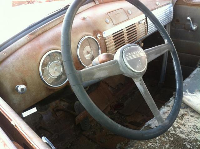

flyovrcntry 115 #98 Posted December 29, 2013 Steve,those interior shots sure take me back.I was about 6-8 yrs old when I would ride with my grandpa.I remember going to Soulard,farmers market in St Louis with him and buying a load of watermelons.I was very young at the time,but I remember him taking them to a supermarket and re-selling them.He could always hustle a dollar like that. Thanks for the pics,if someone had asked me what the interior was like I could not have told them,great memories,I was so lucky to have a grandpa like that. Share this post Link to post Share on other sites
stevebo-(Moderator) 8,744 #99 Posted December 29, 2013 Posi- that is a really cool old truck with just the right patina. IMO it would be a shame to paint that truck. I am with you on just getting it running right. @Flyo- that is what it is all about to me. The memories from the past and making memories going forward. That is the name of my boat too... " Makin' Memories" Share this post Link to post Share on other sites
