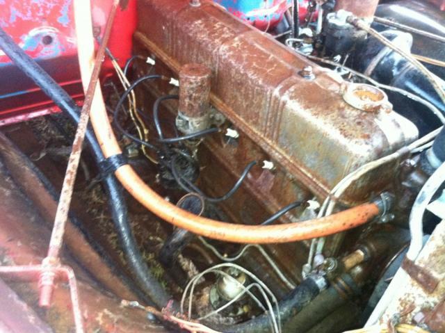

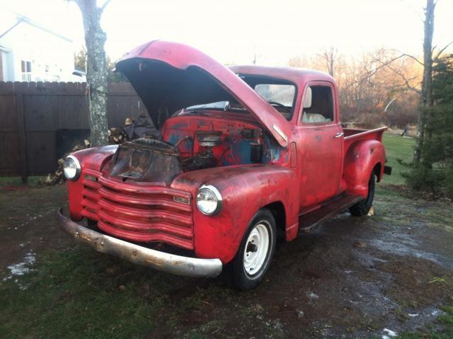

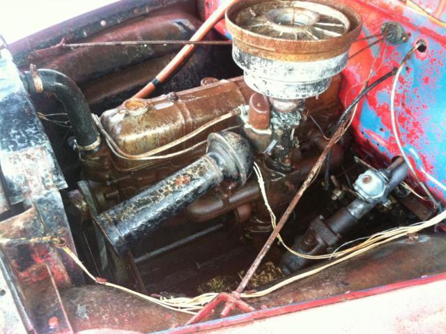

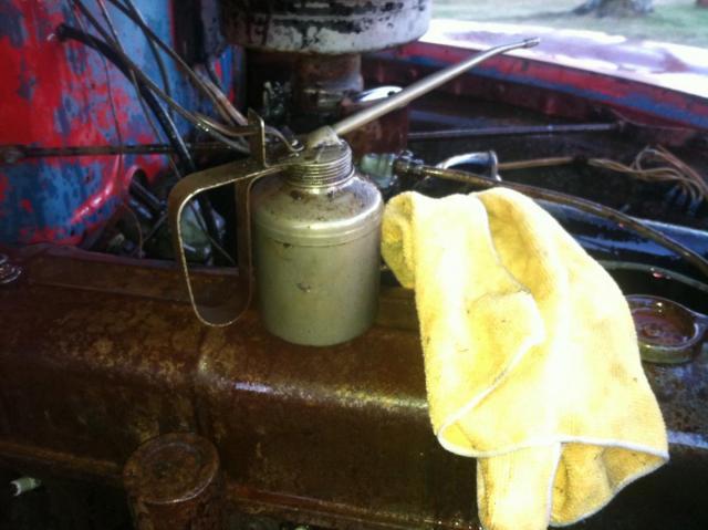

stevebo-(Moderator) 8,742 #41 Posted November 26, 2013 Don- If I did that momma would divorce me. I did not even talk to her about this purchase.... just showed up with it and it did not go over well.... She is coming around tho and likes the truck. Today I figured I should get the pressure washer out and clean up the engine especially around the starter motor while the weather allows me to. I also poulled the plugs and sprayed marvel mystery oil in each cylinder in hopes that it will work the pistons free. What I found is that the valve cover on this motor is vented and not sealed tight. The truck has only 48k on it and the engine compartment looks like someone took good care of it. The carb was covered at some point long ago with plastic to keep debris out. Seems like that would not have been done if the motor was not a runner but we will find out. After pressure washing the engine, I got the "salad dressing" out (marvel mystery oil in a pump oil can) and lubed up all the parts that are suppose to move and the nuts and bolts that I will be taking off. I think the starter motor will be pulled soon and I will check it out and either have it rebuilt or clean it up and put it back in. There was lots of Kansas mud and oil on the motor but it cleaned up pretty good. Here are some updated pics... Share this post Link to post Share on other sites
nylyon-(Admin) 9,066 #42 Posted November 26, 2013 Very nice Steve, I see the blue on the firewall, is the truck originally blue, or is that some sort of primer? It seems to be in pretty decent shape, if you're not picky about OEM, I would certainly put a power booster and 4 wheel disc on there. My old 68 Mustang had manual brakes and steering, not pleasant in the least. Share this post Link to post Share on other sites
flyovrcntry 115 #43 Posted November 26, 2013 That look's like an old AOUGA maybe ? They were pretty common back then. Share this post Link to post Share on other sites
stevebo-(Moderator) 8,742 #44 Posted November 26, 2013 Karl- I am not sure. I think it may have been blue at one point and repainted red many years ago. I really dig the patina of the blue coming through the red. It took several decades to get to look this way... no way am I gonna repaint it. The only thing that will get paint is the motor (if I do a rebuild) and the rims. I am leaning towards new paint on the lettering on the tailgate and the white pinstripe on the cab. Once done... it will get a clear coat. I am bummed as I really want to dig into this project but the weather is not going to allow me and no indoor space to work on it- Uggh !!! I changed the topic title in case anyone is doing a search on this subject... Share this post Link to post Share on other sites
squonk 48,229 #45 Posted November 26, 2013 (edited) No pcv system in the old girl. Since the fill cap is not the "breather " style you needed another vent in the cover. Should be a downdraft tube on there somewhere too. If you have to tear down the motor be careful. That engine could very well have the "pour in" babbit bearings. I worked with a guy who bought a similar truck and it had a knock. It had the pour in style bearings. He ended up putting in a newer version of a 6 banger in. It was like a 69 motor and it was so different on the little things it was really a pain to make it all work. Edited November 26, 2013 by squonk Share this post Link to post Share on other sites
Ken B 3,203 #46 Posted November 26, 2013 I got to see Steve's truck this past weekend, its solid as a rock, I'd say it has less rust on it then most ten yr old trucks. I love the originality of the truck myself. I don't know if Steve mentioned it or not but his Uncle owns a high end machine shop well known for building competition engines, if the original motor gets rebuilt it will be done right. I should have never mentioned to my wife about the Farm truck I almost purchased a month ago. I never asked permission and she never said no, (if she said no it would be in my driveway) but she talked me right out of it. All that left me was truckless and wonderin what could have been...She is in for a BIG surprise when the next one comes along... 2 Share this post Link to post Share on other sites
