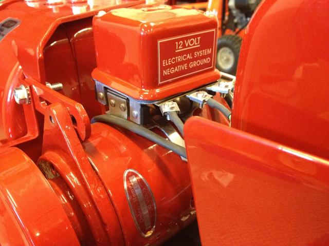

Martin 2,135 #11 Posted November 19, 2013 Yeah, you gotta pay close attention to the 3 or 4 terminal criteria in the specs but this seller usually has them all the time. I first got one of those close to 2 years ago and still good. I have one on my 1057 as well. The best part is plug and play right out of the box. I really don't have the patience for setting up used ones any more. These regulate charge good and everything works as it should..... you can swap out an original type cover with the delco logo stamped in it and they look just right. I did this with my 1057, painted the old cover and put one of the labels I got terry to do on it and good to go!!!!!! Sent from my iPhone using Tapatalk Share this post Link to post Share on other sites
Martin 2,135 #12 Posted November 20, 2013 heres a ebay one of mine, with repainted delco cover and decal....... Share this post Link to post Share on other sites
