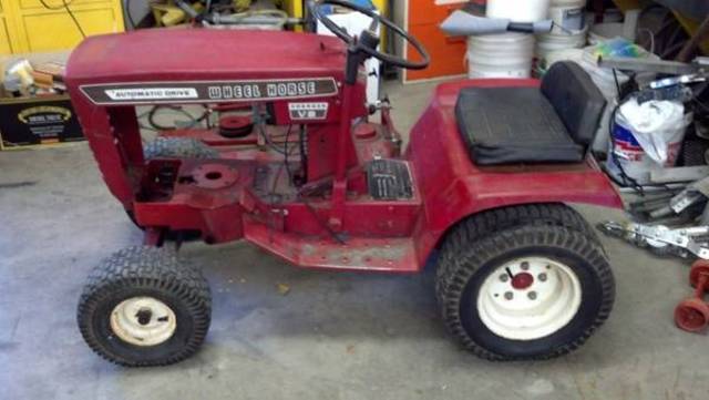

peckens 0 #1 Posted November 16, 2013 (edited) Hi everyone I'm new to the forum. I saw an old charger v8 for sale about 3 months ago and ended up turning the other away. However, I just recently found the add again and now it is half the price. Shockingly the GF gave me permission to buy, as if that matters . As far as I know it is just missing the engine. I figure if I bought it I would put my 14.5 BS motor from my 2001 Murray in it and sell the weak Murray. Just curious if this is a decent buy or even worth my time. I mainly just mow but I do like to pull some heavy stuff. I hear that vertical engines have a bad rep for being on weak tractors. Here is the ad No links to Craiglist ad's please. Edited November 16, 2013 by Sparky Share this post Link to post Share on other sites

Sparky-(Admin) 25,937 #3 Posted November 16, 2013 I mainly just mow but I do like to pull some heavy stuff. I would pass if your looking to pull heavy stuff. Find a C series or a 300-400 series machine for the hard work and let the Murray have the grass duty. Mike.......... 2 Share this post Link to post Share on other sites
oldblue1993 99 #4 Posted November 16, 2013 If you consider the murry "weak" and put the same engine in the wheelhorse your really not gaining anything "yes trans and body will be a little stronger" but your really not gaining. I agree with sparky wait and get something that options and ability are endless. This is just my 2 cents. Share this post Link to post Share on other sites
peckens 0 #5 Posted November 17, 2013 (edited) Ok, thanks! I don't consider the engine weak by any means, but when the whole tractor flexes beneath you over a bump in the ground.... Edited November 17, 2013 by peckens Share this post Link to post Share on other sites
jay in nc 210 #6 Posted November 17, 2013 you wont just put a b&s where the kv181 lived. charger & commando v8 use a cast iron front frame casting with ribs in the bottom. the bolt patern is much larger on a briggs than the kohlerso you will need to make an adapter plate to bolt the engine onto& to the frame Share this post Link to post Share on other sites
peckens 0 #7 Posted November 17, 2013 Very interesting. Thanks, I may hold off and keep looking. Share this post Link to post Share on other sites
