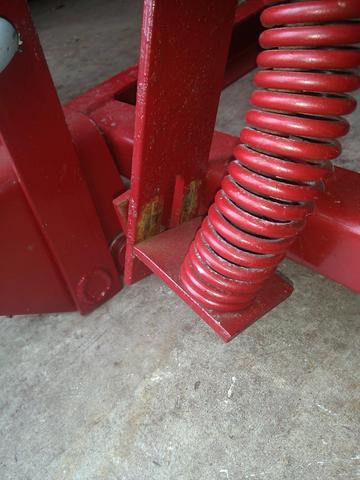

I checked the spring loaded snow plow link and when the rock shaft has a pin in it the spring will compress about an inch and prevents the tires from raising off the ground....  I guess a solid link would lift the front.....see the paint was rubbed away at the bottom of the spring.....
post-1933-0-24046500-1385249905_thumb.jp
