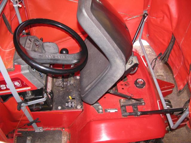

AMC RULES 37,260 #3 Posted November 12, 2013 While not a C series pictured... your setup should be similar. 1 Share this post Link to post Share on other sites
Dieselcowboy 211 #4 Posted November 13, 2013 It will be different than the one in the pic. Almost like an A frame type deal I think, Share this post Link to post Share on other sites
