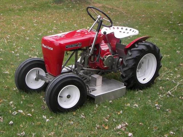

buckrancher 2,697 #35 Posted December 1, 2013 I thought about buying those Brian. They work well? yes I have had good luck with them . all my show tractors were painted with those guns and I use the touch up gun with the 1mm tip for spraying color both urethane or base coat clear coat finishes 1 Share this post Link to post Share on other sites
zanepetty 117 #36 Posted December 1, 2013 Wow. Looks awesome! I thought you mostly used single stage paints? Share this post Link to post Share on other sites
buckrancher 2,697 #37 Posted December 1, 2013 Wow. Looks awesome! I thought you mostly used single stage paints? I do all tinware with basecoat clearcoat all the rest with single stage. The exception is my 854 I did that with single stage paint Brian Share this post Link to post Share on other sites
