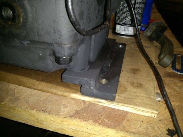

Trouty56 568 #12 Posted November 8, 2013 I went with a couple 3/8 inch by 1 1/2 inch flat steel....cut 4 pieces to the width of the frame.....bolted 2 to the bottom of the oil pan with a 1/8 washer between....then I lined up the pto hoop and positioned the other 2 pieces where existing bolt holes were.and clamped them tight..... sprayed paint under the frame where the holes needed drilled.... Then bolted it all together......positioned things with the pto hoop again and welded the cut pieces in place..... Total height off the frame was 7/8 inch......5/8 from the frame to the bottom of the plate and 1/4 inch plate.....Rube Goldberg but .... Honestly it isn't in the tractor yet but I'm pretty sure it will bolt right on when the time comes.... Share this post Link to post Share on other sites
Rideking 32 #13 Posted November 10, 2013 Trouty - any pictures if your setup? Share this post Link to post Share on other sites
i967mustang 21 #14 Posted November 10, 2013 I had a similar problem with a C160 where the block was different and I had to raise the engine 3/4" and redrill the frame to mount it. I didn't have the original block, as it was blown up when I got it and was a 14 hp instead of the 16 that belonged on it. I found a 16 hp from a wheel horse and bought it not knowing that the base was different but I made the spacers and redrilled the frame and bolted it down. Has been on since half way through the summer and is fine. Share this post Link to post Share on other sites
Trouty56 568 #15 Posted November 10, 2013 (edited) Trouty - any pictures if your setup? Like I said... Rube Goldberg.... Edited November 10, 2013 by Trouty56 Share this post Link to post Share on other sites
posifour11 723 #16 Posted November 10, 2013 That's not bad. Looks like the mount for a 181 on the 70s tractors Share this post Link to post Share on other sites
