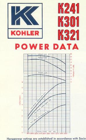

Hydro 131 #12 Posted November 9, 2013 Bill I think the one issue with your opening post is that your RPM when at 3600 is well above your max torque for the 14 Kohler. When the 14 fell to 3200 you were still above your max torque so I believe as Terry M says it was your governor that saved the day. If I'm not mistaken the maximum torque generated by our single Kohler engines is somewhere around 2600-2800 rpm depending on the engine and after that the torque curve drops off. In other words your torque is lower at 3600 than it is at 2800 as an example. I have blown snow now for 2 years now with a 44" 2 stage and an M-16 Kohler. Last year I started running at 3/4 throttle after reading an article that let me calculate the max torque for my engine. I found the engine seemed to maintain better and operate more smoothly at 3/4 throttle than it did at full throttle when powering the blower. With grass however I'm running full throttle because I think the deck cuts better at the higher rpm although the engine is not generating its max torque at that rpm. The 14 I know does not have the torque of the 16 but the principle I believe is the same. I would suggest the maximum torque will rise to a point as the rpm increases but begins to fall off depending on design well before max rpm is achieved. Share this post Link to post Share on other sites
leeave96 496 #13 Posted November 9, 2013 Bill I think the one issue with your opening post is that your RPM when at 3600 is well above your max torque for the 14 Kohler. When the 14 fell to 3200 you were still above your max torque so I believe as Terry M says it was your governor that saved the day. If I'm not mistaken the maximum torque generated by our single Kohler engines is somewhere around 2600-2800 rpm depending on the engine and after that the torque curve drops off. In other words your torque is lower at 3600 than it is at 2800 as an example. I have blown snow now for 2 years now with a 44" 2 stage and an M-16 Kohler. Last year I started running at 3/4 throttle after reading an article that let me calculate the max torque for my engine. I found the engine seemed to maintain better and operate more smoothly at 3/4 throttle than it did at full throttle when powering the blower. With grass however I'm running full throttle because I think the deck cuts better at the higher rpm although the engine is not generating its max torque at that rpm. The 14 I know does not have the torque of the 16 but the principle I believe is the same. I would suggest the maximum torque will rise to a point as the rpm increases but begins to fall off depending on design well before max rpm is achieved. I would agree with this, but suggest that once the RPM's drop below governed speed, the governor has done all it can do - feed the engine the max amount of fuel possible. So next up is the torque rise as the RPM's fall and that additional torque enables the engine to muscle through the tall grass, though at a slower rate of speed. Share this post Link to post Share on other sites
Hydro 131 #14 Posted November 9, 2013 Yes I agree but if you are operating the engine at its max torque, the torque will not rise above that rpm it will fall even with higher revs. The rpm at which the torque is at it's maximum is established by the design of the engine itself based in compression, bore and stroke. At a given rpm lets say 2800 that's as much torque as there is and torque can only fall whether it be at higher rpm or lower rpm. Share this post Link to post Share on other sites
leeave96 496 #15 Posted November 9, 2013 Yes I agree but if you are operating the engine at its max torque, the torque will not rise above that rpm it will fall even with higher revs. The rpm at which the torque is at it's maximum is established by the design of the engine itself based in compression, bore and stroke. At a given rpm lets say 2800 that's as much torque as there is and torque can only fall whether it be at higher rpm or lower rpm. Yes - I think we are on the same page on this. Below is a chart showing the HP vs torque vs rpms. It's a little blurry, but is god info. Share this post Link to post Share on other sites
