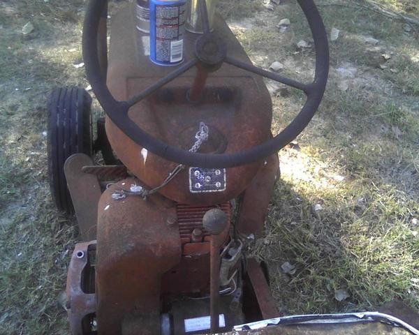

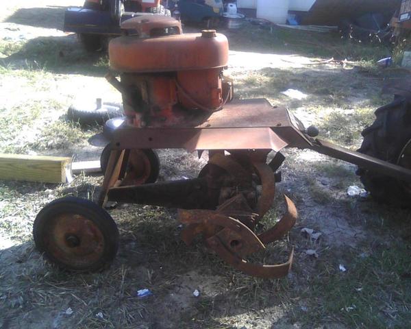

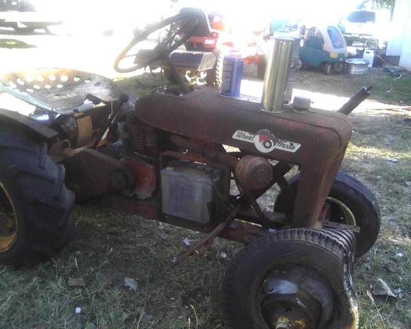

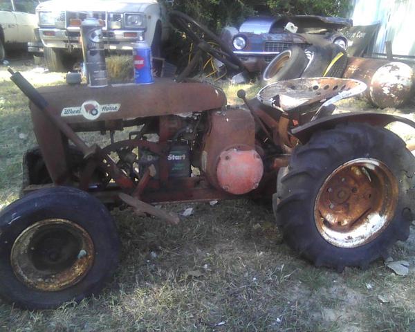

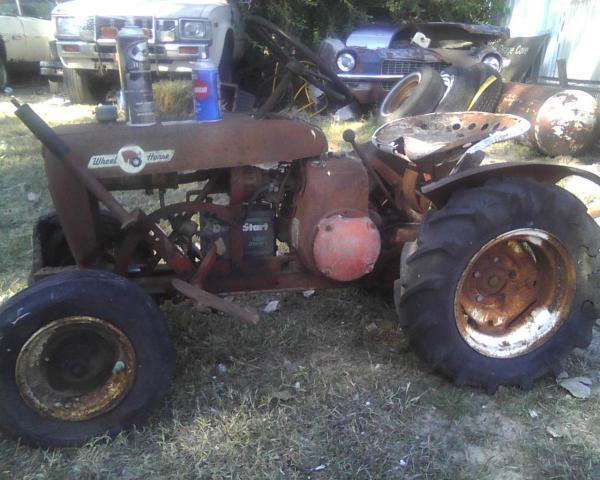

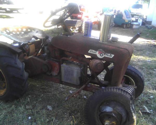

victor3ranger 11 #1 Posted October 31, 2013 I have got myself a Wheel Horse 551 I think and a Wheel Horse tiller, these are something that I want to rebuild and bring back to life if I can find the parts to do so. 4 Share this post Link to post Share on other sites
stevasaurus 23,746 #2 Posted October 31, 2013 Welcome to Red Square...very nice horse and tiller...should be a good project to bring them back to life. Any numbers on the Tecumseh engine??? Should be H55D-2113 a 5.5 horse power Tecumseh/Lawson engine. The transmission is a WH # 5007. How did you find that in Oklahoma?? Give us the story behind this horse. Share this post Link to post Share on other sites

stevasaurus 23,746 #6 Posted October 31, 2013 If you are thinking that it will be hard to find parts for the 551...it looks like you have a fairly complete horse...and some of the harder to find parts are there (the foot rests and the hood does not look like it was cut up). I think you will be surprised that you can find the parts you need, and at a fair price. Doubt you will find them in OK, but we have some very good members in Kansas, Missouri, Texas and a couple in Nebraska that may be able to help. Also have some great members through out the central and north east...just have to ask...thanks for the pictures. There are some on here (including me) that may think you may want to leave it as it is (the finish on the horse)...it is only original once...this does not mean that you can't get it running and make it look nice. I am sure you will get some opinions on this...remember...it is your horse, but see what the members say. That tiller is really cool...WOW Share this post Link to post Share on other sites

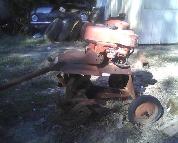

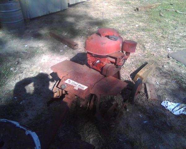

victor3ranger 11 #7 Posted October 31, 2013 I was thinking the same thing about the paint. I do kindof like the rustic look of the little thing. My main goal right now is to get both engines running first and find another set of wheels all around for the tractor and a set that goes on the tiller. Is the tiller a rare thing?? If I can get the tiller going I want to fab up a hitch so I can use it behind other tractors, does that seem like a crazy idea? I wouldn't mess with the original hitch on the 551 or tiller. 1 Share this post Link to post Share on other sites
AMC RULES 37,259 #8 Posted October 31, 2013 Rarely see 'em anymore so...yeah, I think you could call the early tillers rare. Attempted to start either engine yet? Share this post Link to post Share on other sites

CasualObserver 3,416 #15 Posted October 31, 2013 Is the tiller a rare thing?? If I can get the tiller going I want to fab up a hitch so I can use it behind other tractors, does that seem like a crazy idea? I wouldn't mess with the original hitch on the 551 or tiller. I mentioned in your other thread your tiller is likely the matching 1961 model WT-241. Could be a 1962 model WT-242 too... but the designation is really irrelevant, Serial numbers were not documented and they both used the same engine. The Lauson V55D-2339P. Yes, parts will be harder to find, but not impossible. You just have to be diligent about looking. These tillers aren't what I'd call rare, but they are fairly scarce. I have one, I know a few members here who have them and I know of another within 30 miles of me for sale. You won't have to mess with the hitch to make it work with other tractors.... the 551 was the first tractor to use the two piece cast iron transmission casing and the cast iron slot hitch. That slot hitch was universal and fit nearly all models for the next 50 years. 1 Share this post Link to post Share on other sites
