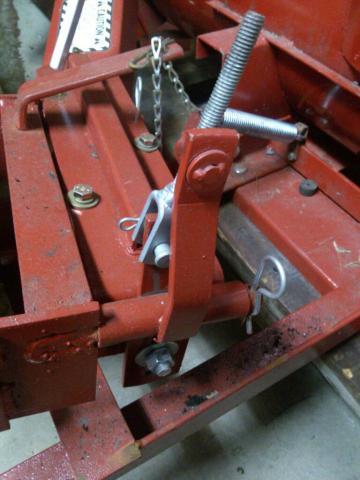

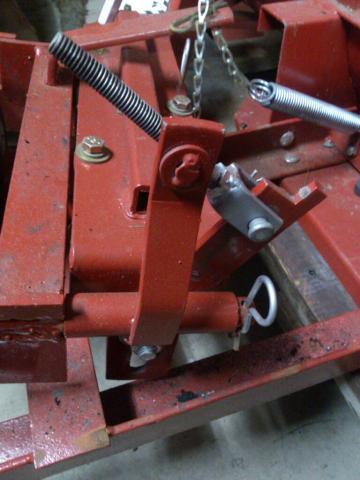

Trouty56 568 #14 Posted November 7, 2013 (edited) Gonna try to upload a picture of the adjuster in the loose position and then in the tight position.... Once in the tight position the nut at the bottom is tightened.... Edited November 7, 2013 by Trouty56 Share this post Link to post Share on other sites
Trouty56 568 #15 Posted November 7, 2013 You can see the adjustment left at the top to tighten more...... about 2 inches. Share this post Link to post Share on other sites
Austin860 82 #16 Posted November 7, 2013 Thank you so much Share this post Link to post Share on other sites
Trouty56 568 #17 Posted November 7, 2013 No problem..... hope it helps you out. Share this post Link to post Share on other sites
