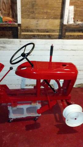

Patrick Reese 40 #11 Posted November 1, 2013 Zane I don't have any experience with napa paints.. everyone has their preferences. Depending on your skill level and the equipment available to you. My son and I recently restored a Commando 6 (there is a thread on it under restorations). We decided to use spray cans. We chose this method as it allowed us to do a little at a time without the worry of gun clean up and such. We used Rustoleum red primer in the larger industrial cans. This primer was nice, it filled well and sanded out smooth. For our top coat we decided to try out a Duplicolor high heat engine paint for the entire tractor. This flowed out well and looked great. The only caveat to any of the spray can paints is lack of hardener. We were patient and let our painted parts outgas and harden for almost a month before messing with them. Key to any paint job is the prep. A smooth surface prior to paint and a dust free environment while painting are really important. To date we are happy with our paint job. 1 Share this post Link to post Share on other sites
zanepetty 117 #12 Posted November 1, 2013 It does look very sharp! Share this post Link to post Share on other sites
