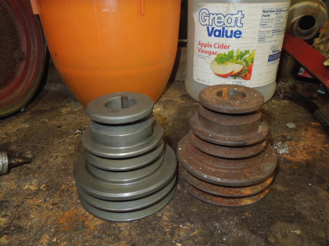

wallfish 20,031 #1 Posted October 29, 2013 I've been using vinegar to clean rust from the inside of gas tanks and it works very well. Since the vinegar was just sitting in a bowl after recently doing a tank, I decided to throw in a rusted pulley which shows the results much better than trying to get a pic of the inside of a tank. These 2 pulleys looked just about identical before soaking one. I let it soak for 2 days and wiped it off with a cloth. Using baking soda afterwards will neutralize the vinegar's acid. There are quite a few other posts on the subject, just type "vinegar" in the search feature. 11 Share this post Link to post Share on other sites

wallfish 20,031 #8 Posted October 29, 2013 Forgot where I heard or read about it but I remember it as cider vinegar working the best but any type will probably do. I do like the rusty stuff Steve, just not inside my gas tanks. Or on pulleys LOL For cleaning out gas tanks it helps to add a handful of screws or two, depending on the size. I use sheet rock screws because they have sharp edges. Shake and swirl them around every once in a while to scrape the rust off too. 2 Share this post Link to post Share on other sites

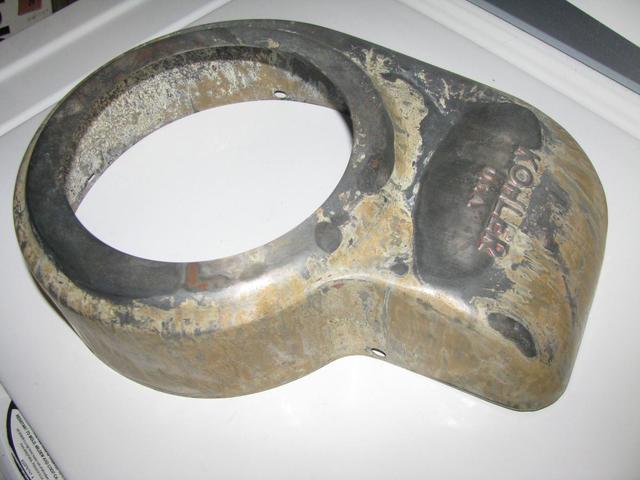

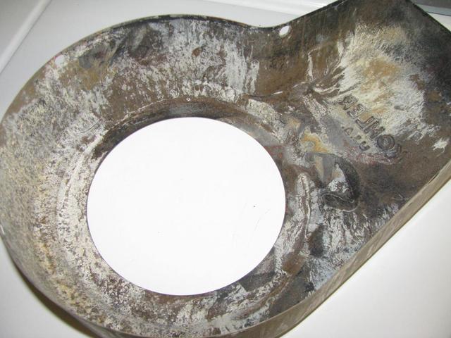

AMC RULES 37,259 #19 Posted November 3, 2013 I stripped this engine shroud down to bare metal almost two years ago. Once finished I mixed up maybe a table spoon of the Eastwood Metal Wash in a spray bottle, mixed with warm water, and sprayed down the tin. Don't wash or wipe it off...just let it dry...leaves behind the white, powdery, zinc phosphate material you see here...which is what prevents the flash rusting from happening. Manufacturers label claims up to three weeks of protection, but...like I said...this has been down in the basement for about two years now. Just hit it quick with a scotch brite pad, and you're right there ready for paint again. 3 Share this post Link to post Share on other sites

Martin 2,134 #22 Posted November 4, 2013 (edited) zinc phosphate is a sealer. we use it in our washers on the paint lines. i would try more of a mist with the spray bottle, thin it a little more....... the brown in your pics, craig, is whats known as 'phosphate burn', just a little too much concentration. light blow off with air would help a little too. you want a real light gray color on there....... hey, i liked the molasses video, darn aussies with their holden toranas........ Edited November 4, 2013 by Martin 1 Share this post Link to post Share on other sites

AMC RULES 37,259 #25 Posted November 4, 2013 I showed you the scotch brite process only because the piece has been sitting so long. I wanted you to see that the condition of the metal I cleaned two years ago is basically just the way I left it. While the zinc-phosphate coating the metal wash leaves behind does promote paint adhesion, the main purpose of this step is to buy yourself a little time, if you know it's gonna be awhile before you actually are able to put the part into paint. No matter what process you use to strip and preserve a part...before painting, you always have to clean the part with a quality automotive wax and degreaser. Share this post Link to post Share on other sites
