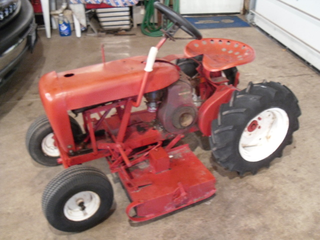

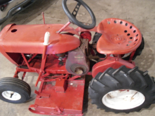

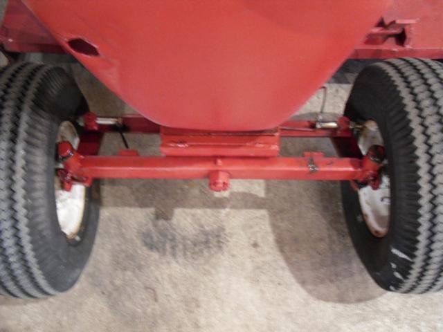

russtiron
This is a different tractor.I have another 55 that I think has the right rims but they don`t seem as wide as later rims.  The tires are marked Sears and are smaller,the rim is also too narrow for the spindle.Chuck

It looks like you have a nice RJ there! These early machines are the coolest!
Wheel Horse Kid
Great looking RJ!
