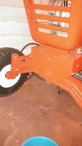

roscoemi 245 #29 Posted November 25, 2013 (edited) I just did the front wheel thing on P'Chops Ranger, at some point somebody put pieces of conduit around the spindles to take up slop from lack of grease. I ordered bronze bushings from McMaster Carr, then bored the existing ones in the wheels for a tap fit. When I bolted the wheels back together, I put them on a spindle to keep them lined up. Seems to work fine and the wobble is gone. Edited November 25, 2013 by roscoemi Share this post Link to post Share on other sites

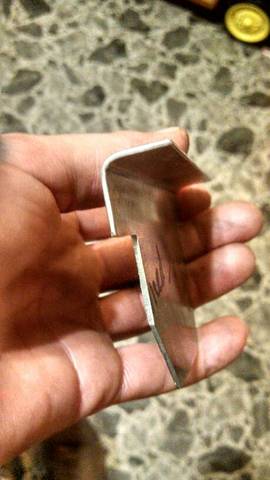

slammer302 2,157 #30 Posted November 25, 2013 I brought the piece of stainless steel for the patch in the hood to work with me tonight so I can get the 90° break put in it and so I can get it cut into the right shape Share this post Link to post Share on other sites

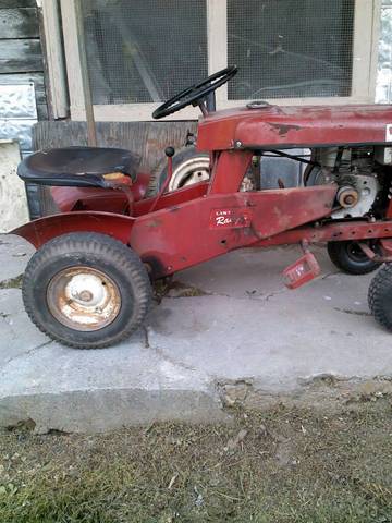

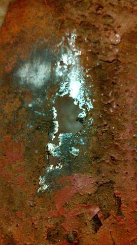

slammer302 2,157 #31 Posted November 30, 2013 I got my patch for the hood all cut out and put the bend in it just have to find a welder to use. I'm thinking of just buying a cheap flux core welder so I don't have to run around and use other people's stuff here's what I have though Share this post Link to post Share on other sites

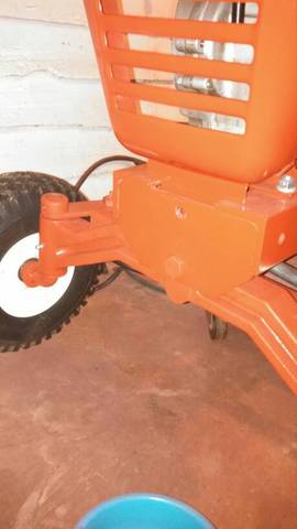

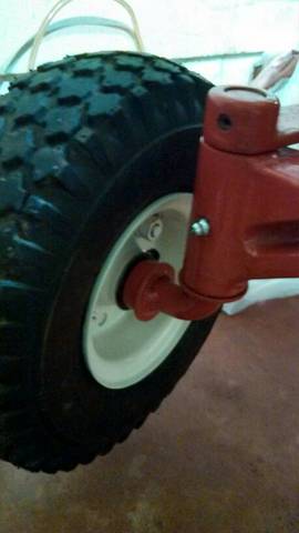

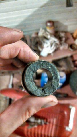

slammer302 2,157 #32 Posted November 30, 2013 I also have the front wheels done to the bushing were very worn I think their about 1 inch now they alot of play in them and were starting to fall apart Share this post Link to post Share on other sites

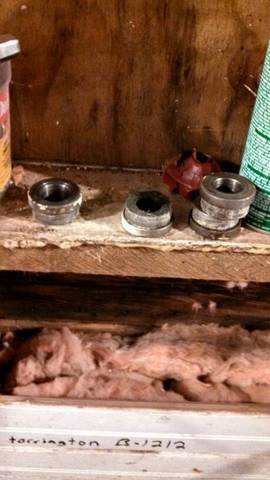

slammer302 2,157 #33 Posted November 30, 2013 I also had a problem that I did not think of when I changed the bushings out with bearings the bushings were made the wheels much wider but I came up with a solution that seems to work well I had two 3/4 inch collars left over from building sub 400 so I put them in first on each side fit perfect did not even have to shim just put snap rings on 1 Share this post Link to post Share on other sites

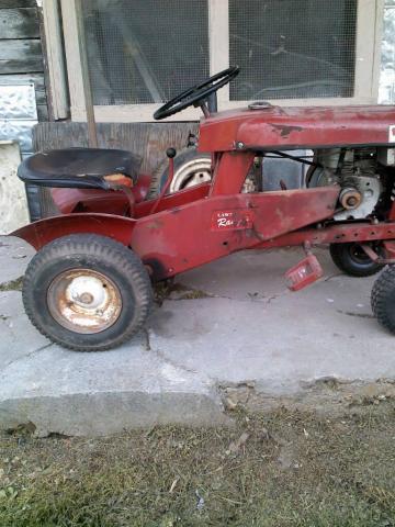

slammer302 2,157 #36 Posted December 22, 2013 I think I most everything painted for the lawn ranger and I ordered the back tires from gct Friday 56$ shipped to my front door went with ag tread I just need to get some decals and finish putting back to gether Share this post Link to post Share on other sites

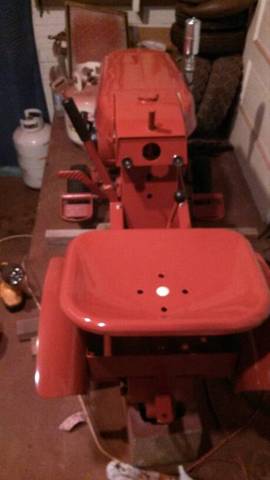

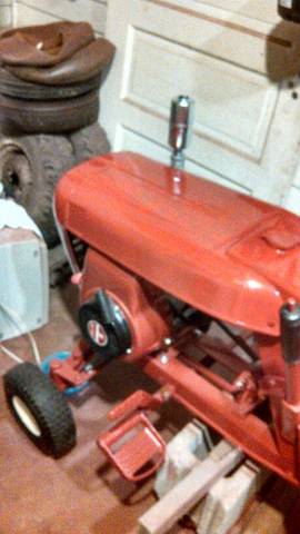

slammer302 2,157 #38 Posted December 22, 2013 Here's a few more pics Share this post Link to post Share on other sites

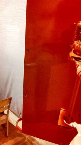

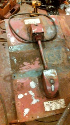

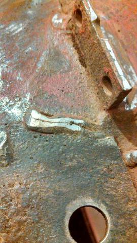

slammer302 2,157 #39 Posted December 23, 2013 Well I started working on the deck its pretty well shot but I'm going to do my best to keep it working. I've seen people use these decks with giant rust holes in them and only wire holding them together Share this post Link to post Share on other sites

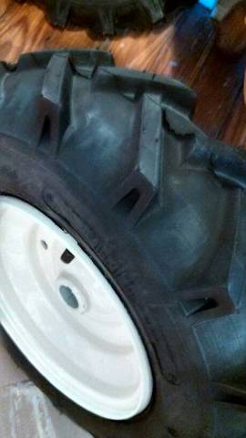

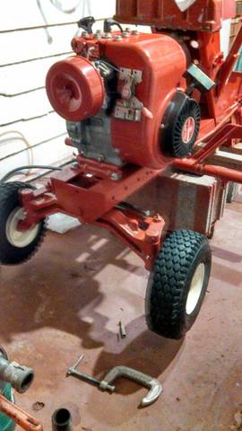

slammer302 2,157 #41 Posted December 30, 2013 Got the tires yesterday so got them mounted up and put on I really like the way they look and you can't beat 53$ shipped to my front door. I will have my son mowing the yard before we know it 1 Share this post Link to post Share on other sites

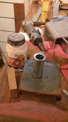

slammer302 2,157 #42 Posted January 9, 2014 Got the sleeve for 80 cents but will have to cut it down to size Share this post Link to post Share on other sites

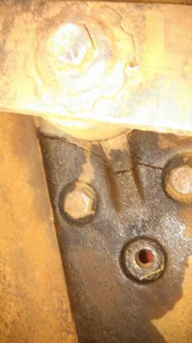

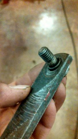

slammer302 2,157 #44 Posted January 18, 2014 Just cut out a plate to help reinforce the transmission I think if it works well I will make sum more for the others Share this post Link to post Share on other sites

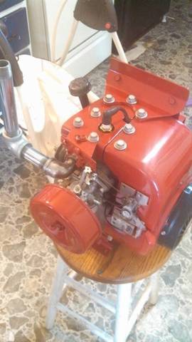

slammer302 2,157 #47 Posted February 21, 2014 Here's a pic Share this post Link to post Share on other sites
51Chevy 66 #48 Posted February 21, 2014 What type of coating on the muffler did you do? Because I'm going to put a stainless pipe on my 854 resto, I just bought a shower head muffler so I want to make it look like you did to your muffler. Share this post Link to post Share on other sites
slammer302 2,157 #49 Posted February 21, 2014 I just bought the muffler at a auto parts store for 8$ it looked like that when I bought it Share this post Link to post Share on other sites
