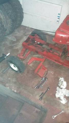

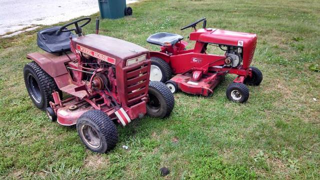

slammer302 2,157 #1 Posted October 26, 2013 I just finished up my suburban restoration and I thought a winter project would be fun for me and my kids to mess with on these cold days it came down to the 857 I just got back or my lawn ranger I picked the lawn ranger its been my little worker this summer so I thought I better give it sum love. 857 going to wait in line here's wait I got so far 2 Share this post Link to post Share on other sites

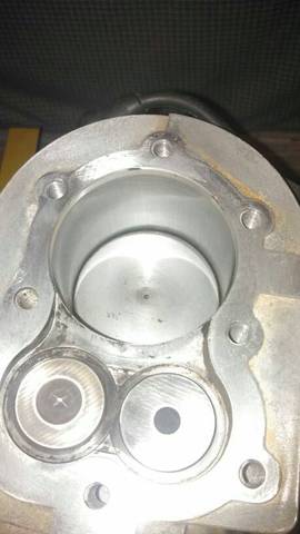

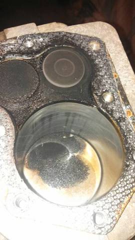

slammer302 2,157 #6 Posted October 27, 2013 Started on the motor last night I was hoping this motor had the cast iron sleeve I don't it does Share this post Link to post Share on other sites

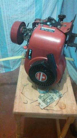

slammer302 2,157 #7 Posted October 27, 2013 The techy ran good though so I don't know what to do opinions???? Run it or Rebuild? Sent from my XT907 using Tapatalk 2 I got it cleaned up 1 Share this post Link to post Share on other sites
sorekiwi 761 #8 Posted October 27, 2013 If it ran well and didn't smoke much, I'd just lap the valves, clean the points and set the timing while the heads off. Then put it back together and run it. There is something cool about 50 year old parts doing what they have been doing for 50 years (at least in my twisted head...). Share this post Link to post Share on other sites
slammer302 2,157 #9 Posted October 27, 2013 I like it to Share this post Link to post Share on other sites

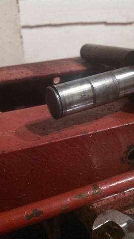

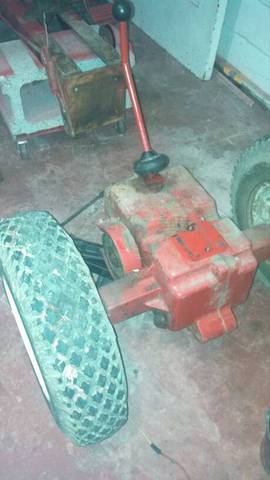

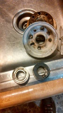

slammer302 2,157 #12 Posted October 28, 2013 Got the front end apart all looks good except the front spindles look worn from the wheels that were on it don't have bearings they have some kind of bushings in them don't think they will be going back on Share this post Link to post Share on other sites
SousaKerry 503 #13 Posted October 28, 2013 They all look that way, there is a Babbitt material inside the rims and as long as they are well greased they should last, but 50 years will do a number on anything even with good grease. I just put mine back together greased the heck out of them and hoped for the best. One time I did try to sleeve another tractor then I made custom bronze bushings for the rims, it really did not work very well as I got the tolerances too tight. If I had it to do over again I think I would try to bend up new spindles. Share this post Link to post Share on other sites

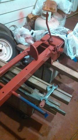

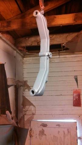

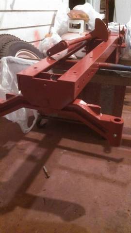

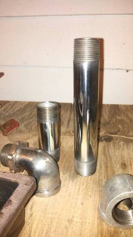

slammer302 2,157 #15 Posted November 2, 2013 I've got the frame cleaned and primed and most the front end peaces waiting on the head gasket to show up ordered yesterday off eBay and got the pipe for the exhaust polished up Share this post Link to post Share on other sites

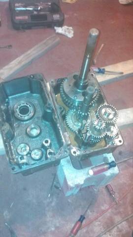

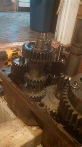

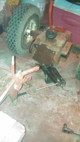

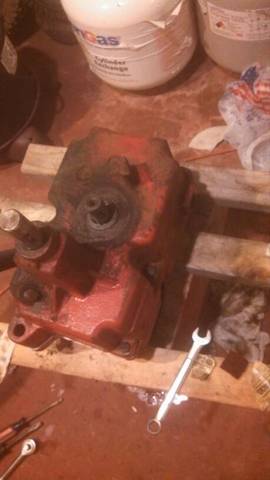

slammer302 2,157 #18 Posted November 5, 2013 Got the trans apart and cleaned and back together 3 Share this post Link to post Share on other sites

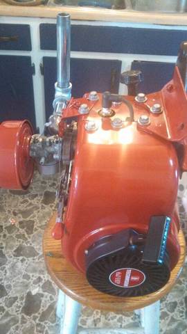

slammer302 2,157 #19 Posted November 15, 2013 I've not got to do much but I did get the motor done Sent from my XT907 using Tapatalk Share this post Link to post Share on other sites

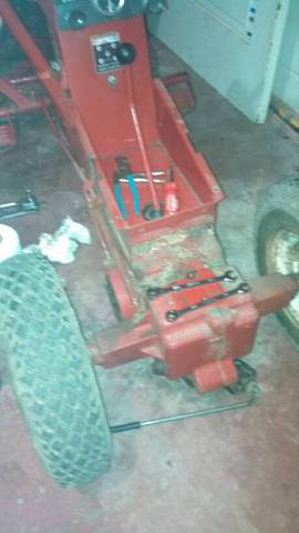

slammer302 2,157 #20 Posted November 20, 2013 I have the trans attached and the front end is coming along 1 Share this post Link to post Share on other sites

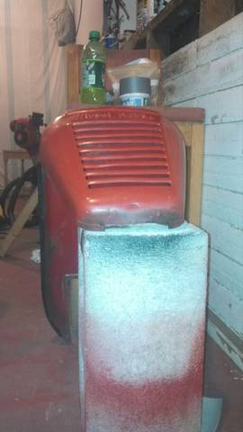

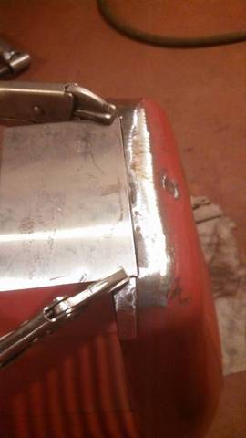

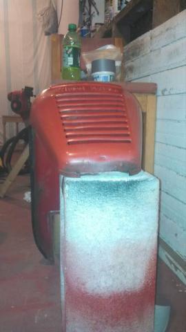

slammer302 2,157 #22 Posted November 24, 2013 I've been working on getting my hood some pics of what my hood should look like this is the patch I've been working on Share this post Link to post Share on other sites
slammer302 2,157 #23 Posted November 24, 2013 I meant if someone could post a pic of what it should look like would be helpful. Of the front were it attaches to the front of the frame Share this post Link to post Share on other sites

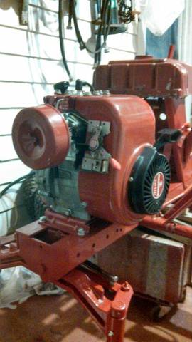

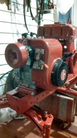

slammer302 2,157 #24 Posted November 25, 2013 Put the motor back on today I still need to get some decals for it 1 Share this post Link to post Share on other sites
slammer302 2,157 #25 Posted November 25, 2013 I was able to get the bushing out of the front wheel I'm going with bearings hope they will be easier on my spindles Share this post Link to post Share on other sites
