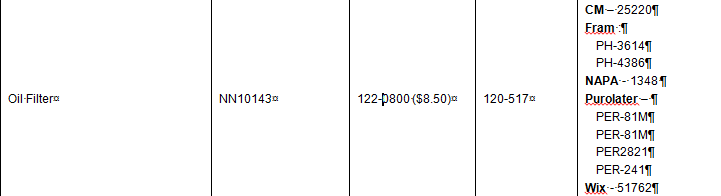

P3x 60 #7 Posted October 26, 2013 Compiled a doc for my 520 with cross references to different vendor parts. Several vendor Oil Filters are listed. Share this post Link to post Share on other sites
