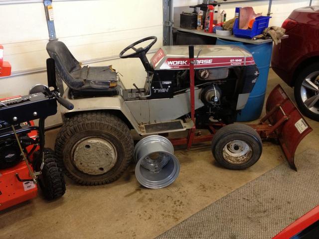

Martin 2,133 #13 Posted October 26, 2013 (edited) if you are going grey or silver check out this thread. i used dupont silvadillo PFA500M9 on these parts, fairly close match for the wheel color on my 416H.... also, heres a wheel i did around 6 months ago this color..... Edited October 26, 2013 by Martin Share this post Link to post Share on other sites
