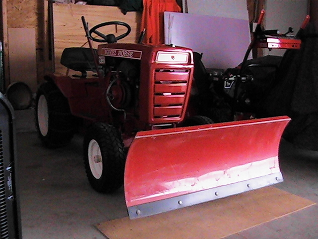

zanepetty 117 #2 Posted October 21, 2013 The 8 HP tractors are surprisingly stout. My friend has one with a k181 Kohler. I have a 7 HP and it also surprised me when I got it. I have a dozer blade/snow plow on it and I have graded my driveway ,(steep) , and it never bogs even in high gear. Share this post Link to post Share on other sites
