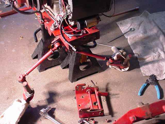

waltsuz 12 #1 Posted October 18, 2013 I got a 520 setting on a jack with the front tires off the ground and the wheels removed. If I grab a wheel axle I can move the entire front axle assembly back and forth a 1/2 inch maybe a bit more. Before I tear into this and start dealing with making bushings or whatever, what would you consider to be excessive slop in a front end. The tractor steers and does everything just fine but its getting 300lbs of front end loader and I am curious to whats normal...Thanks Walt. Share this post Link to post Share on other sites

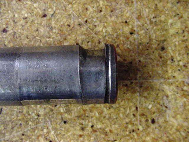

waltsuz 12 #4 Posted October 18, 2013 Ck the axle pivot pin Well you called that one right. This pin is about as worn as one can get. This tractor is getting a total once over. The farther I dig into it the more I find...Thanks for the advice....Walt Share this post Link to post Share on other sites

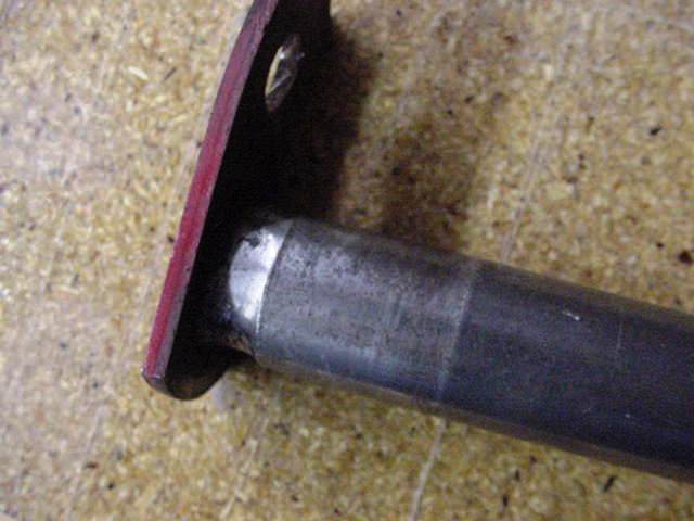

waltsuz 12 #10 Posted October 19, 2013 This tractor has 1140hr's on it. I just picked up this machine 2 weeks ago. What happened is that the retaining bolt on the rear of the pin was gone. The attachment tab welded on the pin was rotating from the axle pivoting and waller'd up the pin. The front hitch is bad just like what Don1977 showed a good fix for. I have ordered a new pin and found another front hitch off ebay. This is hopefully a $30.00 fix, if not, I will fab something similiar to the previous mentioned repair... Share this post Link to post Share on other sites
