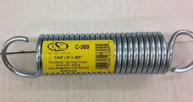

persof 14 #7 Posted October 19, 2013 I was at Tractor Supply today and It appears to be the same as a WH lift assist spring except that is is a bit larger in diameter. Thanks Francis Share this post Link to post Share on other sites
