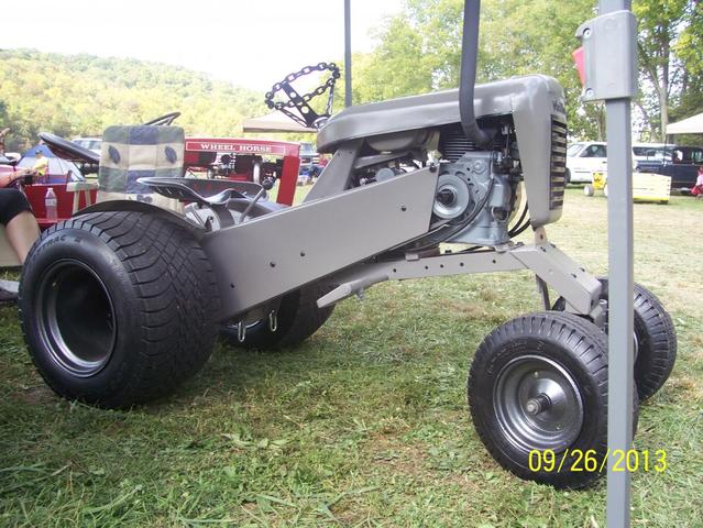

rockinhorse 45 #7 Posted October 20, 2013 Good News I got the tractor fixed today. Turned out not to be the carb after all . I tryed everthing that everyboby said one at a time to see what worked .Well after a few hrs. i tryed a idea that David Clements suggested. He said to change the condenser it might be bad . It sounded odd but i had tryed everything else. Got a new condenser and put it on and now the tractor runs great. I would have never have thought a bad condenser would make a engine run like it was a bad carb. Now the tractor is fixed and no more show to go to. Thanks again for all your help . Here is a pic of the tractor. 3 Share this post Link to post Share on other sites

clemedc 29 #9 Posted October 21, 2013 awesome tractor Karl I am glad I was able to help Share this post Link to post Share on other sites
Coadster32 793 #10 Posted October 22, 2013 Glad to hear you got it fixed. Can we check out a few more pics from different angles? That is one awesome looking ride!! Share this post Link to post Share on other sites
AMC RULES 37,261 #11 Posted October 22, 2013 Waaaaay cool ride...glad you got it fixed. Any video of it running? Share this post Link to post Share on other sites
