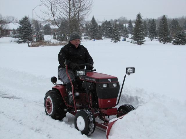

How do HDAP's with rear wheel weights (without chains) do on snow?  Thinking of using HDAP's and rear wheel weights this winter on the C-101 to plow with.  Thanks.
Hydro
I use AG's for winter but in reverse they do not work well.  I can push just about anything unless I'm on ice.  Chains are not great for your paved driveway but otherwise....
