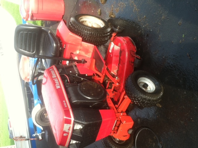

stnygrm 11 #1 Posted October 13, 2013 Just picked a 310-8 (21-10k802) in great shape but mows terrible. The deck is a 05-42mr04. Not sure if the wrong blades are on this deck, while mowing strips of uncut grass are visible and the rear deck wheels leave impressions in the yard. Any help would be appreciated. what length blades should be on this deck and does any one have a part number for new ones. Thanks in advance! Share this post Link to post Share on other sites

tunahead72 2,645 #5 Posted October 17, 2013 A couple of things in your photo don't look right... First, the lift lever is in the raised position, but your rear deck wheels appear to be touching the ground. That shouldn't happen. Also, it's hard to tell, but there might be something wrong with the way the deck hitch shaft is connected to the Tach-a-matic hitch. Can you post a close-up photo of that area, basically right under the engine? Are your blades sharp? And they're not installed upside down, are they? The owner's manuals that Garry linked (810403 & 810518) have very good instructions for mounting the mower, adjusting the level, and troubleshooting quality of cut problems. And the parts list (810407) is a great reference for figuring out how these things are supposed to go together. I'd recommend you take a look at those manuals, and look closely at your machine to see if everything is hooked up correctly. Let us know what you find. And Share this post Link to post Share on other sites

stnygrm 11 #7 Posted October 18, 2013 Thanks, will let you know how it works out! I will get more pics this weekend and thanks for the help! ok, looked at the horse tonight, the deck arm just flops down when you lower it, thinking that the pin is in the wrong place or the chain is too long. will be at it tomorrow am early! any suggestions? Thanks again! Share this post Link to post Share on other sites
stnygrm 11 #8 Posted October 18, 2013 Thanks, will let you know how it works out! I will get more pics this weekend and thanks for the help! ok, looked at the horse tonight, the deck arm just flops down when you lower it, thinking that the pin is in the wrong place or the chain is too long. will be at it tomorrow am early! any suggestions? Thanks again! also the fork on the right side of the front deck bar seems to have no place to go! any pics of the front mount would be great, and a martin senour paint code as I am doing a full restore once I get the mechanicals done! Share this post Link to post Share on other sites
leeave96 496 #9 Posted October 19, 2013 Thanks, will let you know how it works out! I will get more pics this weekend and thanks for the help! ok, looked at the horse tonight, the deck arm just flops down when you lower it, thinking that the pin is in the wrong place or the chain is too long. will be at it tomorrow am early! any suggestions? Thanks again! The lift lever should flop all the way down. The chain should have slack in it. The chain is for lifting only. The deck is held at the front by the mid attach-o-matic and the rear deck wheels should ride on the ground. They also set the cutting height. Unless something is damaged, your deck should easily give carpet smooth cut. Share this post Link to post Share on other sites

stnygrm 11 #11 Posted October 19, 2013 Went and picked up a 48 inch side discharge today! I think the 42 rear discharge deck was bent, the new 48 seems to mow decent even before I level it and sharpen the blades! Now the resto can begin. Also the guy I got the deck from has a rototiller, back blade and a snow blade, are these attachments worth picking up and if so how much? thanks and I will keep you updated on the 310-8 Share this post Link to post Share on other sites
tunahead72 2,645 #12 Posted October 19, 2013 I don't believe Wheel Horse ever recommended a 48" deck for the 310-8. Not to say you shouldn't try it, there are others here who run that combination with good results, but there are also those who say 10 HP isn't enough power to run that deck well. Depends on your grass, and how often and under what conditions you mow. I'd be interested in hearing how it works out for you. Share this post Link to post Share on other sites
