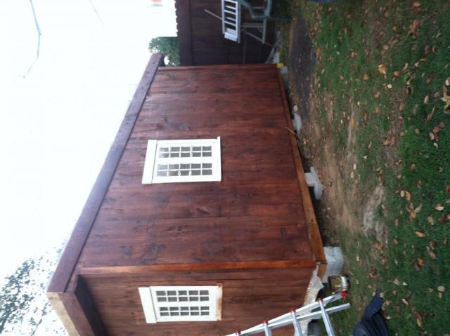

truckin88 104 #63 Posted October 24, 2013 Steve, glad to see you went with that stain it is worth the extra $$. Once it is done being sticky it really gives the wood a natural feel and brings out the grain. After it drys for a few weeks it will have the natural country look you were looking for, but protect the wood, it is a great product I just used it on 250 ft of cedar fence. Share this post Link to post Share on other sites

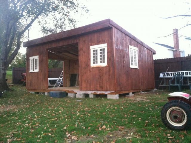

stevebo-(Moderator) 8,742 #64 Posted October 24, 2013 I agree Will. I finished up the stain today and put a first coat of Ben Moore Bone White on the windows. I hope to have the edge metal back from fabrication tomorrow and get it installed this weekend. Here are a few pics of the color combo... 2 Share this post Link to post Share on other sites

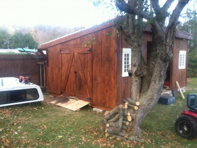

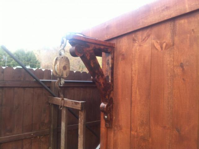

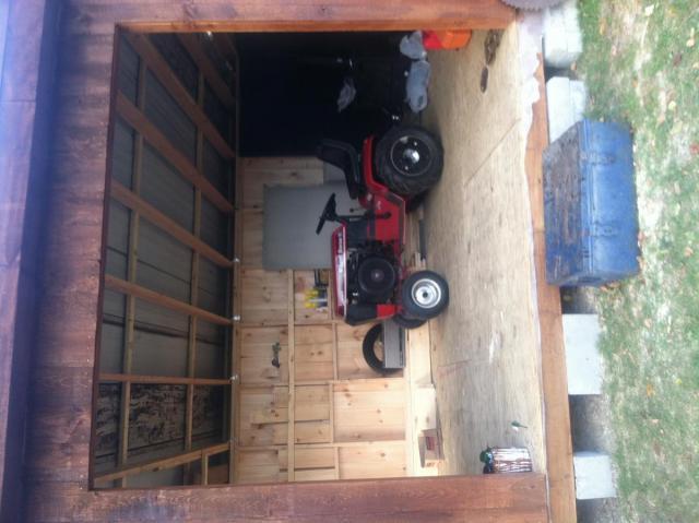

stevebo-(Moderator) 8,742 #67 Posted October 28, 2013 Got a little more done this weekend. Got the smaller doors installed and stained. Went to the flea market this morning and picked up a few goodies including the hand crafted wooden bracket. On Friday I picked up some original old style barn door rollers that will go on the front. I plan on splitting the doors so I needed 4 brackets which I currently have in the e tank. I was able to get the ramp built and backed up the very first horse inside to get a perspective on space. Cousin Timbo will be proud... Share this post Link to post Share on other sites

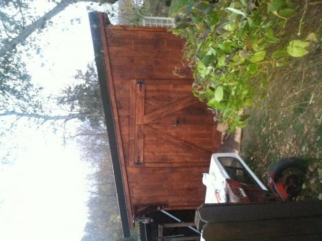

stevebo-(Moderator) 8,742 #74 Posted October 28, 2013 Bob- Those tree guys get all the money to take down those big ones for sure. Today I got the rake and head closure metal back from fabrication. I had just enough time to get one side on and the other side started. You cannot see from the pictures but there is what is called a cleat strip or hook strip that goes on first and then bottom edge of the rake metal actually hooks into it to hold it tight. The top is then pinned into the clip with a fastener. I need to finish up the other side then install the head closure detail. The will need to be pinned with fasteners on the front as they did not fab a hook strip on the front rather the back side will be cleated to the panels. It is coming along... Share this post Link to post Share on other sites
