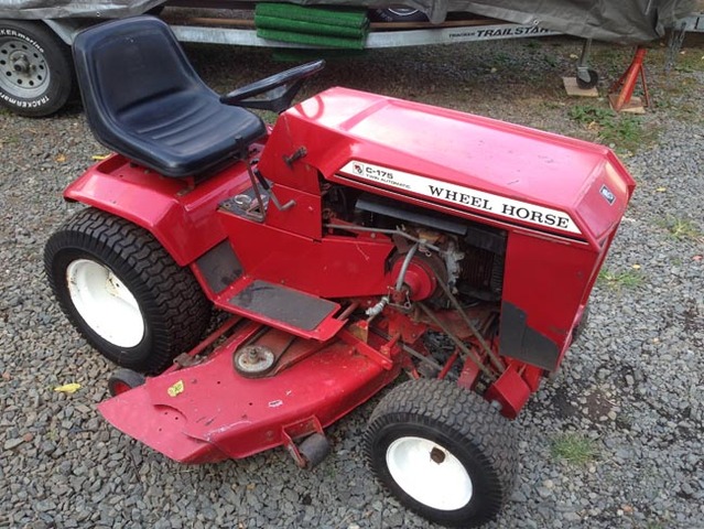

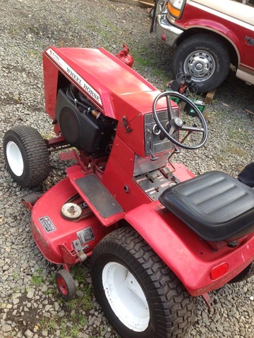

Hey Guys,
Newbie here and I could use your help. I found a decent deal on a C-175 last week, and I brought it home, but I'm not sure which year it's from. I couldn't locate an ID tag on it. It's got a KT17 series 1 on it, metal body, red hood. The deck has a tag on it, and is a 48MS02, but not sure if it's original to the tractor. I'm pretty certain it has the Eaton transmission, but not 100%.
Also, I'm trying to get the deck off, and I can't budge the mule drive knob. I'm going clockwise, but it doesn't want to go. Any tips on that?

Ed Kennell
Nice .....  Looks like the C-175's were made 1980 thru 1984 and the auto's were all Eaton 1100-032's.   Try ccwise on the mule drive tensioner.

Thanks all for the advice. Any idea from the pics which year it may be? Just curious.

Kelly
Careful turning the knob it only has a small roll pin holding it on, light heat on the treads can help, as for the year looking at the pics I'm going to say 1984 it looks like it has the correct metal fenders with out the body line at the bottom back edge, the ID tag would have been on the panel below the dash, but I see a alum. panel in it's place, so the tag is probably long gone.
Sparky
The first year was 1980 for the C-175. Midway thru 1980 they changed from Sundstrand hydro's to Eaton 1100 hydro's (that's what you have). 1984 was the last year for this machine and the only year for the metal rear fender pan from the factory. If its the original rear fender its a 1984 but its very easy to swap a metal fender onto a tractor with a busted up plastic fender so without the model# ID tag its hard to tell.
