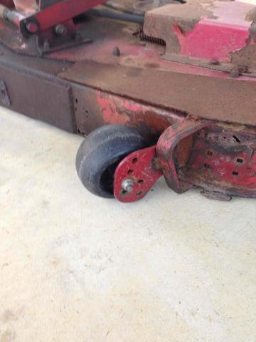

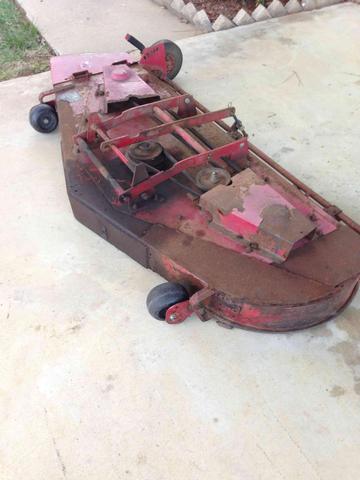

motox25 36 #1 Posted October 12, 2013 The '91 520H I recently purchased to restore came with a 60" deck. The model/serial number is unreadable and I need to order some parts for it (blades/belts). I've posted some pics below hoping someone with the same model can send me their model/serial. Also, I am trying to decide between keeping the deck and restoring it or trading down for a smaller 48" deck. I've heard both good and bad things about the deck, the bad mainly that it can weaken and break the frame on the tractor and I definitely do not want that to happen. What are your thoughts? Share this post Link to post Share on other sites

daveoman1966 3,884 #3 Posted October 12, 2013 The spindle belt is # 112449 and the blades are 112947 (3). Your deck has lots of weld repair plate on it and the cost of the belt + blades will probably hurt. I have a good 60" deck shell here in n/w PA but Tulas OK is too long a shot to drive to consider. Share this post Link to post Share on other sites
motox25 36 #4 Posted October 12, 2013 Thanks guys. Yeah that would be quite a drive unfortunately, I think my deck MIGHT be salvageable, it only has a few small places where it has rusted through. I am more concerned with the effect the heavy deck might have on the frame than the condition of the deck. Looks like blades and the PTO belt will run me around $180. Share this post Link to post Share on other sites
cheesegrader 436 #5 Posted October 14, 2013 That deck looks pretty rough, and all I see is the top side. I worry that it was left covered with wet grass, and I wonder what shape the spindles and bearings are in. I love my 60" deck. Blows my 48" SD deck away. I haven't used anything but the 60 for three years. I have heard stories of frame failure using a 60, but wonder if it wasn't from striking the deck against fixed objects. Unlike a 48, the 60 will not give or bend. Leverage against the frame is also increased by the wider deck. Smash a 48 into the house, and you just get a bent mower shell! Share this post Link to post Share on other sites

motox25 36 #8 Posted October 14, 2013 It was definitely left outside, and with rotting grass on it because I sprayed it off after I got it home. It seems the PO kept the tractor grease bearings lubricated well, I just hope he did the deck also. All the blades turn free with no apparent bearing noise. One of the belt guards has been welded on top of the deck so I am going to grind the welds to remove it and replace the stripped out bolts with bolts and lock nuts since it goes straight through. I have found grease zerks on the 2 side spindles and the idler arm but didn't see one for the middle spindle, do I have to remove the pulleys to get to it or does it not have one? How do the NAPA belts hold up compared to the OEM belts? Share this post Link to post Share on other sites

cheesegrader 436 #10 Posted October 14, 2013 The zerk for the center spindle is under the pulley, at the front of the deck. Share this post Link to post Share on other sites
