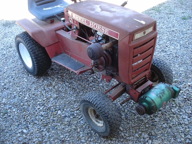

bean 85 #1 Posted October 9, 2013 (edited) I bought a belt driven generator several months ago. it is 2000w and was coupled to a kohler k181. the pulleys have a 2to1 ratio, so the engine turns a 1800rpm while the generator turns at 3600. the previous owner said he ran it for 48hrs at a time while camping. I am mounting it to my '73 8hp in case of power outages, which we have at least 1 per winter. most of the time they are 12-24 hrs, but have been 2-3 days a few times. I have a Honda eu1000 for our electronics, but it won't power any appliances just curious, how comfortable would you be running your k series for 2-3 days? my other option is to use a honda gx200 6-1/2hp to power everything. the one advantage to that, I can install a tri-fuel carb on the Honda engine, and run it off of propane. we have 2 100 gal tanks. that way, I wouldn't have to get up in the middle of the night to refuel. also, do I need to ground the tractor, when the generator is in use? Edited October 9, 2013 by bean Share this post Link to post Share on other sites
Sparky-(Admin) 25,064 #2 Posted October 9, 2013 I suppose if the oil is fresh and full the Kohler should be fine running for all those hours, maybe do an oil change after running for a couple days but.....its a splash lubed motor and running that long at such a slow speed might be a bad idea. I think it should have the pulleys swapped so that the engine is running at least 3000 rpm's for proper internal lubrication of the motor. For simplicity and longer run time between fill-ups the Honda idea is your best bet. Not to mention they are a quieter motor. Personally I have never grounded a generator feeding my house and the reason is this. If a tree (for example) comes down and whacks the wires out at the street you have lost everythinmg BUT the ground to your house. Your ground to your house comes from your outside ground rod (2 rods if its a newer house in Connecticut) and maybe your water pipe feeding the house if its not plastic. You never loose your house ground in a power outage. If the generator is being used on a construction site and all the guys plugged into it are relying on the generator to provide a 120v hot leg, nuetral and a ground then it should have a rod driven next to it and a wire run from the rod to the genset. My opinion of course, I'm not a generator expert. Mike............ Share this post Link to post Share on other sites
SousaKerry 503 #3 Posted October 9, 2013 Considering that may of these engines were used on generators, refer units, water pumps and such all long hour running applications you should be fine as long as your maintenances are up to date. Although I would ditch the 2 to 1 pulley setup as the engines are designed to run at 3700 for proper cooling, lubrication, and full power. IT will be louder and more thirsty then your Honda 1 Share this post Link to post Share on other sites
bean 85 #4 Posted October 9, 2013 thanks gentlemen. I was also concerned about the slow speed in a splash lube engine. the genny requires 5hp at full load, so I hate to run an 8hp engine to use it. but, it's not really a big concern, as it is just a few times a year. the noise factor is my biggest concern. the po said he ran 2-300 ft of extension cord to get it at a tolerable noise level. this is an older Dayton brand generator. the engine is 1969, so I think the head was the same year. it has one wire inside the receptacle box. the other 2 legs of the receptacle are directly grounded to the steel box. Share this post Link to post Share on other sites

bean 85 #18 Posted October 10, 2013 (edited) did a rough fit to see how the pulleys line up. got this old mule drive mount with the tractor. the shaft is toast, so figured it would make a good base. Edited October 10, 2013 by bean 1 Share this post Link to post Share on other sites
