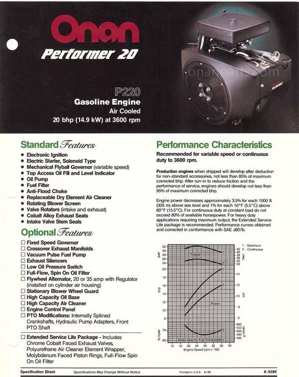

JackC 619 #4 Posted October 7, 2013 The ONAN P Series put out significantly more torque at lower RPMS than the Kohlers. See attached PDF from a 1988 sales manual. You will need to rotate the image counterclockwise with your PDF viewer. Share this post Link to post Share on other sites

leeave96 496 #8 Posted October 8, 2013 The ONAN P Series put out significantly more torque at lower RPMS than the Kohlers. See attached PDF from a 1988 sales manual. You will need to rotate the image counterclockwise with your PDF viewer. ONAN vs Other - torque.pdf That PDF makes the Onan sound like a great engine! Share this post Link to post Share on other sites

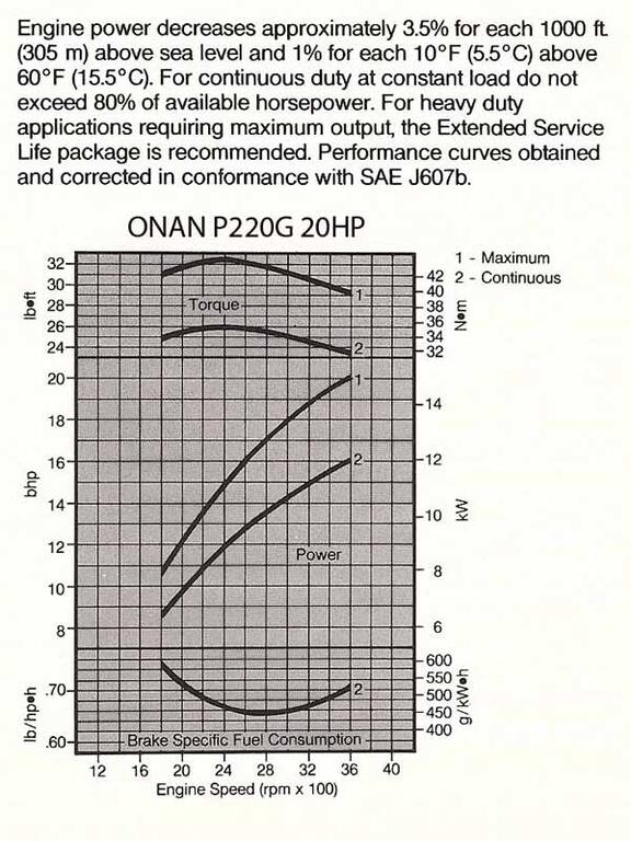

onanparts.com 185 #23 Posted May 29, 2020 This is a published Dyno chart for the Onan P220G. Most GT and welder applications had the XSL, Extended Service Life package so the maximum ratings on the graph can be used. Sweet spot for torque is between 1800-2800 RPM. That's a nice wide range! A major reason the Onan's are so popular, no need to wind them up to 3600 RPM. But if you do, no problem! :) Note Onan states "Recommended for variable speed or continuous duty at 3600 RPM" This publication was NOT put out by the Onan marketing dept. They didn't need to play games with real specs. 3 Share this post Link to post Share on other sites
tom2p 2,396 #24 Posted May 29, 2020 what is the XSL / extended service life package ? Share this post Link to post Share on other sites
onanparts.com 185 #25 Posted May 29, 2020 3 minutes ago, tom2p said: what is the XSL / extended service life package ? See under the Optional Features list. Bottom. Hard faced exhaust valves and chrome piston compression rings. Usually just the top groove ring was chrome. The oil filters were not optional as stated, they screwed up there! Became standard on all the Performer P-Series engines beginning in 1986. Prior to that oil filters were optional. Share this post Link to post Share on other sites
