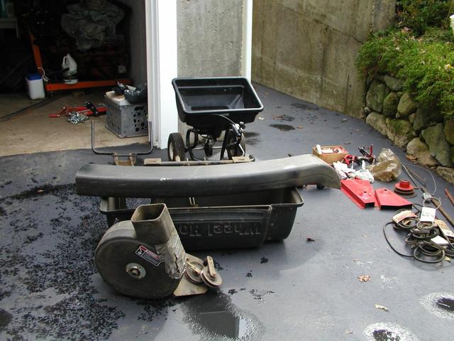

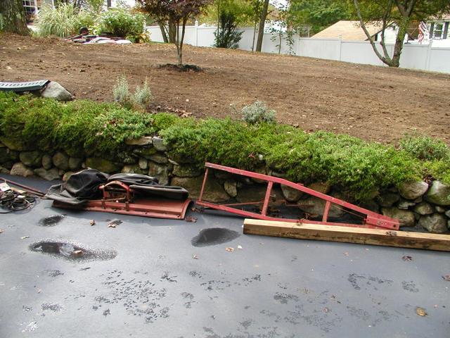

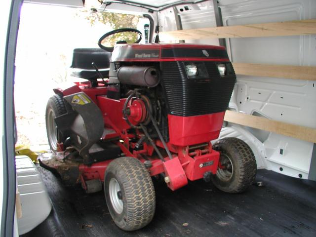

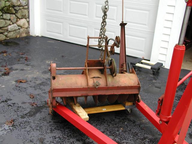

P3x 60 #14 Posted October 22, 2013 Ah yes pictures. Took several when I first got it home. Came with quite a few components I have yet to go through. 1 Share this post Link to post Share on other sites
leeave96 496 #15 Posted October 22, 2013 Dang! That is a lot of stuff there - all you need now is a clevis hitch and moldboard plow for the rear and you are set! Share this post Link to post Share on other sites
P3x 60 #16 Posted October 23, 2013 There was quite a bit included with it. Have no idea what the snow blower's model number. Looks to be a fairly old unit in Ok shape. Any tips on how to identify it? Took the 310 out for a 10 minute romp to get the tranny oil sloshed around to drain any residual moisture. Ran in all gears Hi and Low and operated well. A little difficulty here and there to shift into gear but hoping it will resolve after I change the oil to 80/90W Gear oil. Will be mounting the deck to see how it cuts next. First time I've driven a non-Onan WH. Surprised at how smooth and quiet the Kohler 10 operates. The steering on the tractor is tight compared to my 520. Will have to watch tight turns in hi gear so I don't flip it! Share this post Link to post Share on other sites
