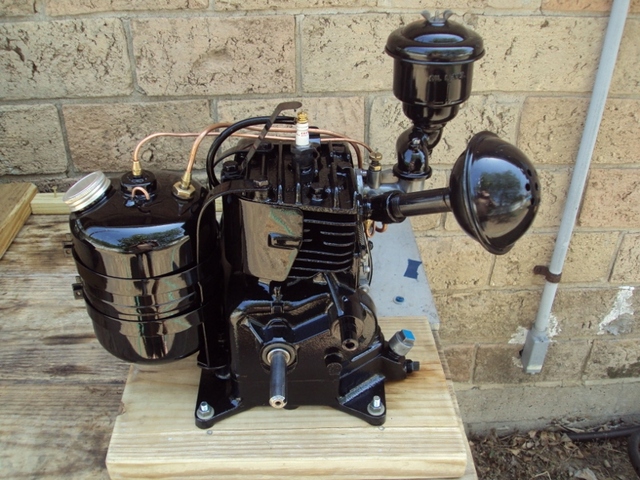

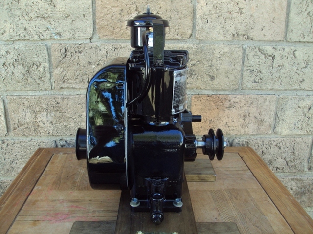

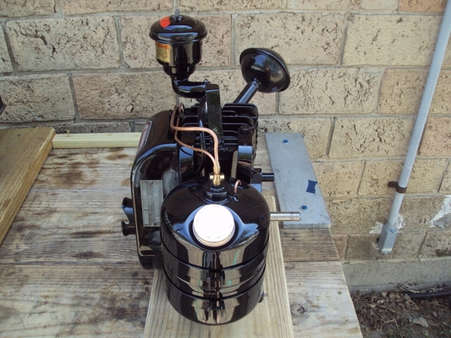

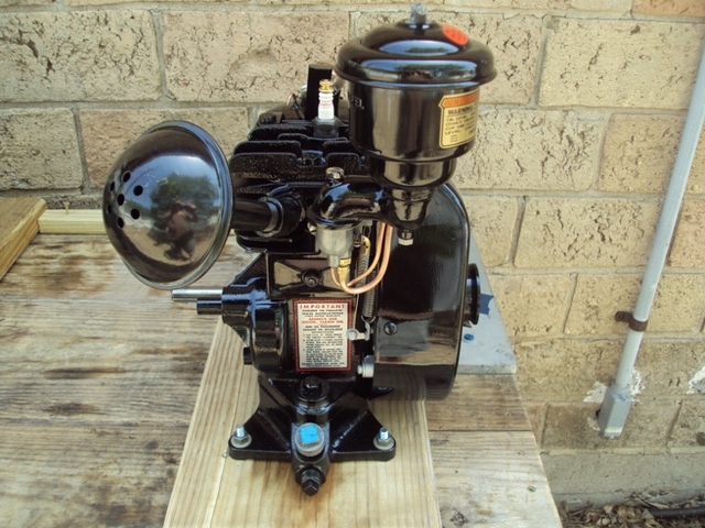

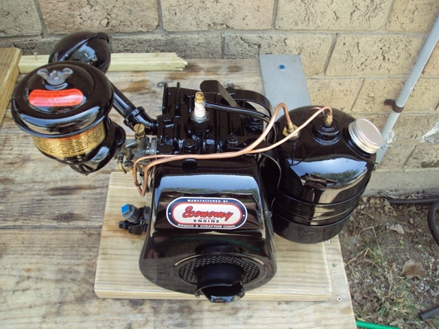

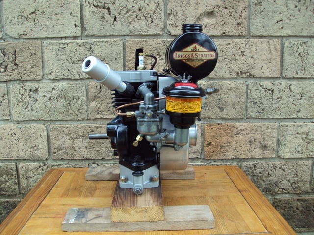

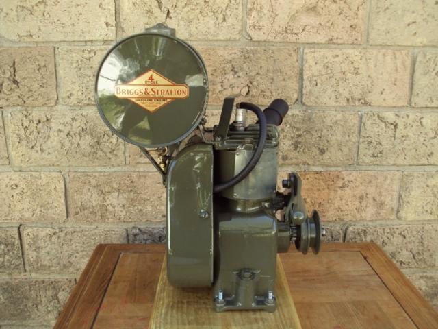

bowtiebutler956 650 #1 Posted October 6, 2013 (edited) I know I haven't been around much lately, but I have stayed busy with projects. Primarily my old Briggs engines. I've restored quite a few over the last several months. Along with a vintage minibike project for my son Nathan. Here is the first engine I wanted to show you guys. Its a 1941 Briggs Model U. These have a very unique fuel system on them. They use engine vacuum to keep the engine running the same whether the gas tank is full or almost empty. On engines of this era, it was very common for them to run rich with the tank full, and to lean out when they were getting low. This engine was Briggs answer to that problem. Its strange, if you even loosen the gas cap when the engine is running it will cough, and sputter like its going to die. Most of these were sold to Sears for use on old David Bradley walk behind Garden Tractors. Hope you enjoy the pics. Matt http://youtu.be/KUBF3hknpWI Edited October 6, 2013 by bowtiebutler956 4 Share this post Link to post Share on other sites

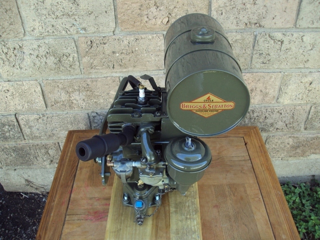

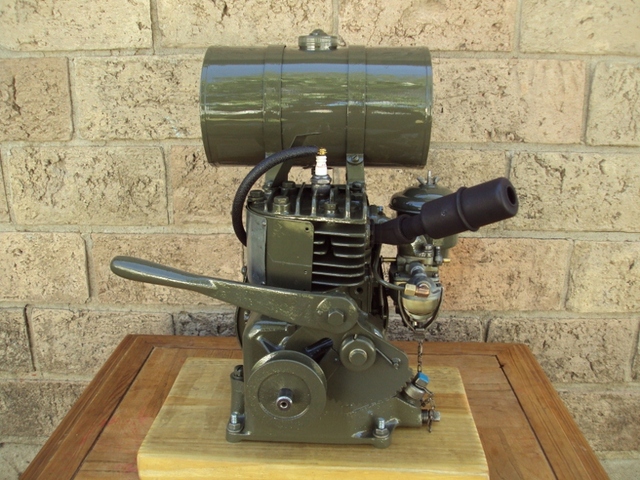

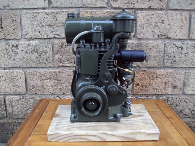

bowtiebutler956 650 #3 Posted October 6, 2013 (edited) This next engine is a 1943 Briggs Model N Lever Start. It was a Military engine, although I can't tell you exactly what its use was. Briggs made many different versions of the Model N for military. I got alittle carried away on this resto, as it shouldn't have been this glossy for a military engine, but you know how it is. You'll see on a military engine I restored later that I resisted the urge, and went low gloss, but not this engine. Matt http://www.youtube.com/watch?v=sTUufejGHjk Edited October 6, 2013 by bowtiebutler956 3 Share this post Link to post Share on other sites

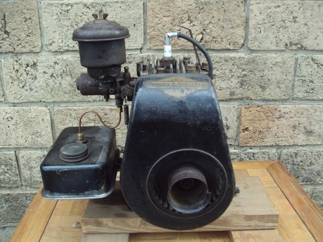

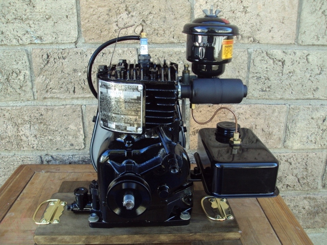

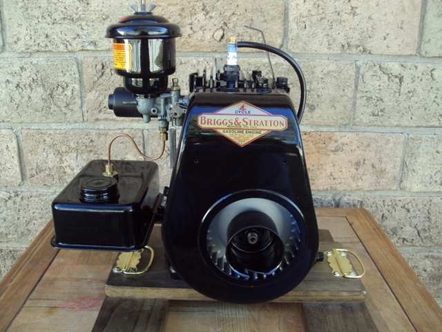

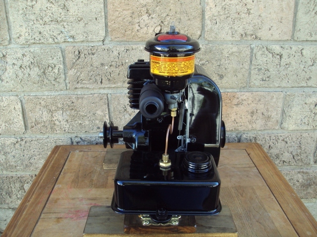

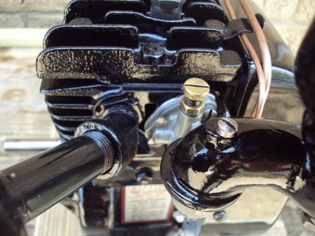

bowtiebutler956 650 #4 Posted October 6, 2013 (edited) This next engine is a 1948 Briggs NS. Its a model N with a suction feed carburetor, hence the S. I really like this engine, and it turned out really well. The first pic is the before. Matt http://youtu.be/CTOfjZig588 Edited October 6, 2013 by bowtiebutler956 3 Share this post Link to post Share on other sites

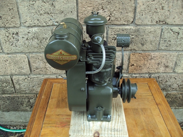

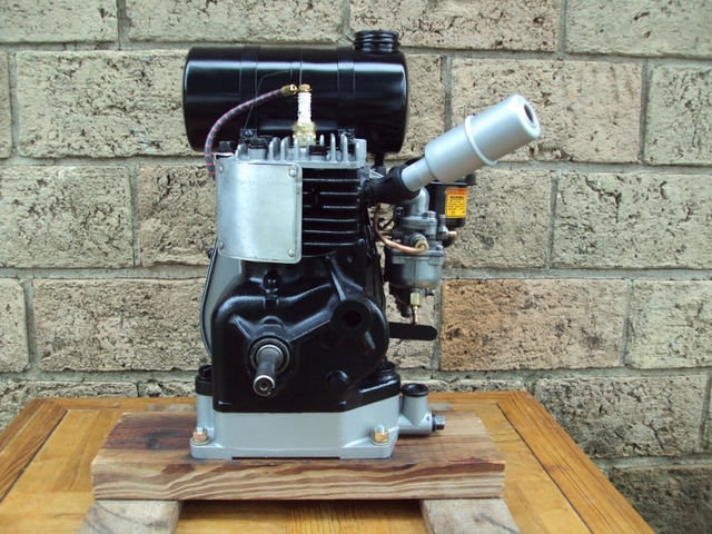

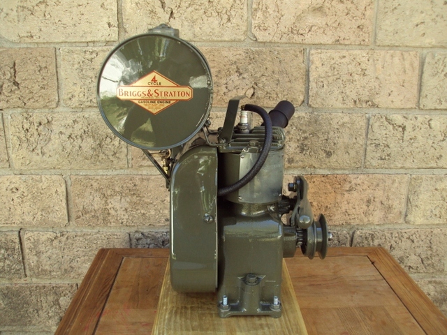

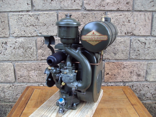

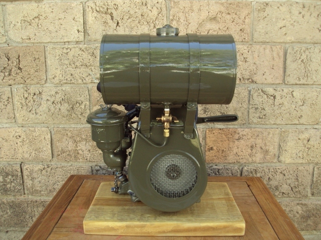

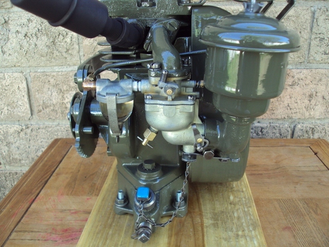

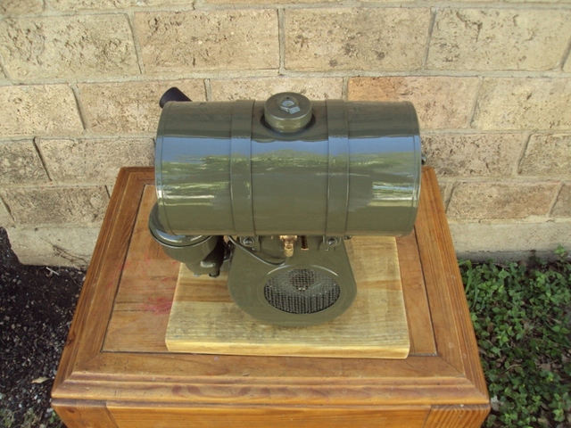

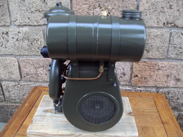

bowtiebutler956 650 #5 Posted October 6, 2013 This next one is a 1945 Briggs Model N kick start. It is a military engine, and this particular engine was used on old WW2 air compressors used for airing tires, and small jobs. You will notice this engine's fuel shut off goes thru the gas tank, and its ignition kill is actually a button in the shroud, rather than just a piece of metal that grounds the spark plug. You'll notice I resisted the urge to paint this one with a high gloss finish. It was really hard though! Matt http://youtu.be/-NjdrL9wpII 4 Share this post Link to post Share on other sites

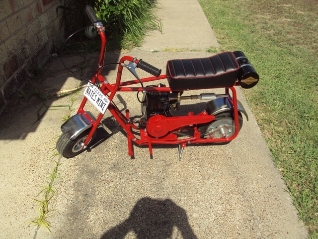

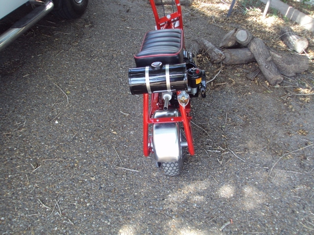

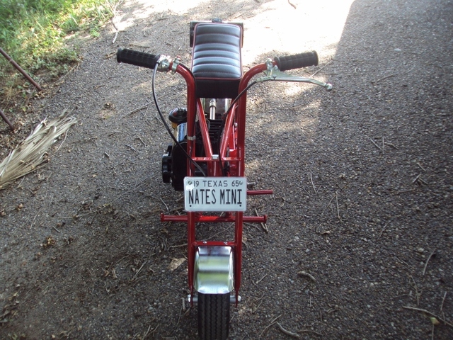

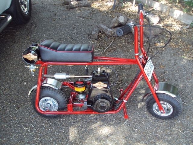

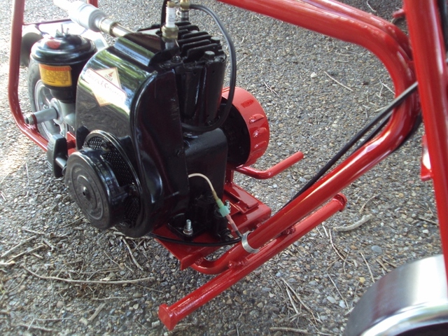

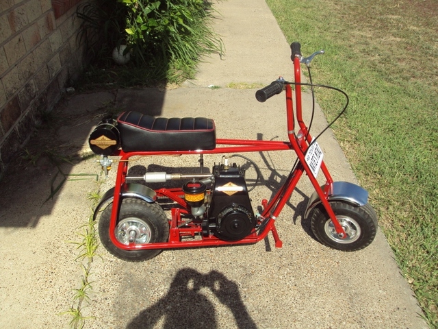

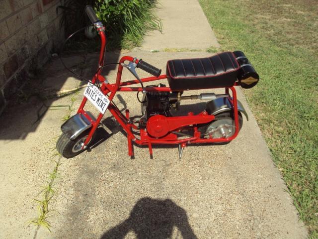

bowtiebutler956 650 #6 Posted October 6, 2013 This last one is the mini bike project I did for my son Nathan for his 9th birthday a month ago. Its an Azusa frame with an early 50's Briggs model 8 on it, which is almost the same as a model N, but with a bigger 2.25in. piston, as apposed to the Model N's 2.00 piston. The engine is rated a 2.25 horsepower, which is perfect for a first mini bike. This thing gets a lot of ride time on it, and so far that old Briggs is doing great! Matt 3 Share this post Link to post Share on other sites

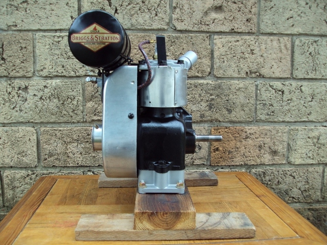

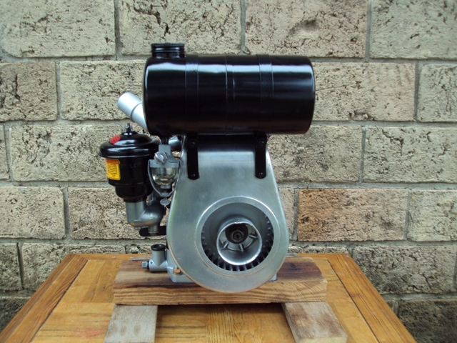

bowtiebutler956 650 #8 Posted October 6, 2013 Just realized, I almost forgot one. This is a 1948 Model N, which was the only year Briggs used an aluminum shroud, start cup, and shiel that the tag is mounted to, on their engines. Not all 48 models were equipped this way, just a few. Matt 4 Share this post Link to post Share on other sites

Anglo Traction 761 #10 Posted October 6, 2013 Marvelous work Matt , It's clear why you have been quiet for a while and your Son must be 'Over the Moon' to have a Dad that produces things like that Mini Bike for him. Thanks for sharing . 1 Share this post Link to post Share on other sites

dclarke 4,274 #12 Posted October 6, 2013 Outstanding work, Matt! I Really..... Really like that mini bike. 1 Share this post Link to post Share on other sites

bowtiebutler956 650 #19 Posted October 6, 2013 Marvelous work Matt , It's clear why you have been quiet for a while and your Son must be 'Over the Moon' to have a Dad that produces things like that Mini Bike for him. Thanks for sharing . Thanks Richard, and I take that as a very high compliment, coming from someone of your skill level. Yes, Nathan loves his mini bike, and after doing this for Nathan, and restoring the 52 Bantam for Danny last year, and giving my oldest son Jimmy his first truck this year. Now my daughter is expecting some sort of gas powered machine for her next birthday! I'm thinking whatever it is, it will have to be pink. We'll see. Matt 1 Share this post Link to post Share on other sites
