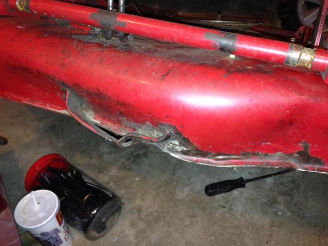

bigfkd22 11 #1 Posted October 5, 2013 So I go pick up a 522xi I get it home and find this. It was dark and very late when I finally get to the guys house and didn't see this. I knew it had a bad center spindle before I bought it. I can fix the spindle although the parts are really high. What about fixing the damage to the roller and front lip of the deck? Beat it out and ditch the roller or take it to a shop? Thanks Share this post Link to post Share on other sites

546cowboy 302 #3 Posted October 5, 2013 I'd say port-a-power and some heat might work to push it back out but that never will look real good. As far as the roller bracket, you'll probably have to make a new one. There is a fab shop close to me that could probably do it better than I could though. I think professional help is required there. Share this post Link to post Share on other sites

boovuc 1,090 #6 Posted October 5, 2013 That is bad but it can be fix by any decent welder. Knowing how heavy those decks are, that is amazing how that happened. Makes me wonder if it fell while in storage. Can't imagine him hitting something with it that would do that without "other issues" at the same time. Share this post Link to post Share on other sites

RMCIII 840 #8 Posted October 5, 2013 You know, now that I look at the deck again, it's not the HD deck. Not sure what that deck is, but that does not appear to be the original deck that came with it. Take a look at this: I know that decks change and had different styles. The deck on mine has an added steel reinforcement around the bottom. I have seen a couple other decks like it in here. Not many though. Share this post Link to post Share on other sites
daveoman1966 3,884 #9 Posted October 5, 2013 In your case, the lack of the steel reinforcement bar around the bottom is a bonus... repair will be considerably easier. I have saved some almost as bad as yours, considering the price to replace the deck, it was worth it. Time consuming, but worth it. You'll never get it perfect. Use a small hyd jack to force it back to shape. When in close-to-shape is attained, acetelyne torch stress area to keep shape after releasing the pressure. Get some big C clamps, heavy flat stock, hammer, hammer, pry bar...whatever it takes. 1 Share this post Link to post Share on other sites

doc724 927 #11 Posted October 6, 2013 The damaged deck is a probably a 44 inch deck. They were only made for a couple of years and they did NOT have the reinforced bottoms that are on the 48 inch and larger decks Share this post Link to post Share on other sites
