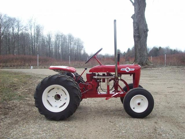

Ed Kennell 45,919 #5 Posted October 1, 2013 Here is a stack I made from an old chrome bed rail from a junkyard pick-up. I actually got 4 pieces with this bend. Just cut to length and weld in the correct size NPT pipe fitting . Share this post Link to post Share on other sites

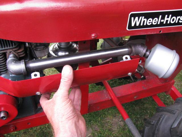

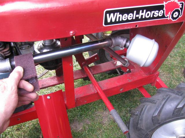

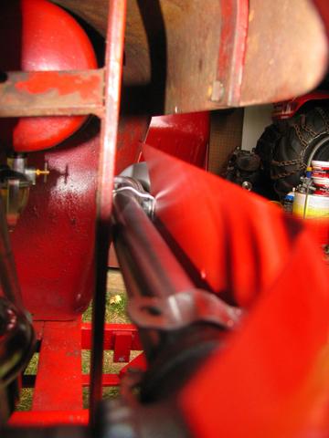

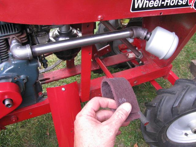

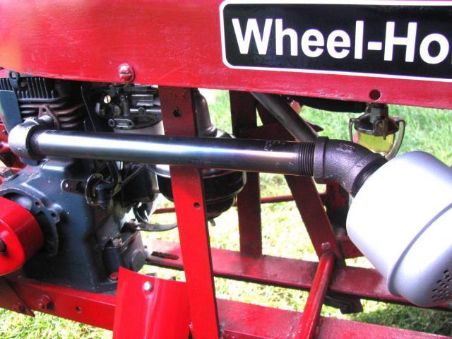

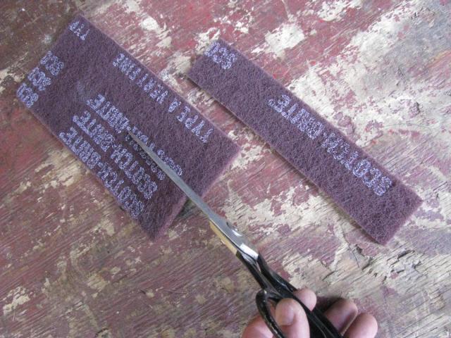

AMC RULES 37,258 #8 Posted October 3, 2013 (edited) I've been hitting the new black pipe exhaust on my RJ with some red scotch brite I cut into strips. When you think of it, take a strip, wrap it around the pipe. Then using both hands, push pull the strip using moderate tension, back and forth, from a few different angles, left to right, to ensure your hitting all sides of the pipe. Maybe takes a whole minute to complete, looks a whole lot better than the rust that black pipe turns into once the black burns off. Check it now and then...once you see it bluing up...take a minute and just hit it again. I just popped the heat shield off to show you this process... notice the bluing starting to accumulate, it's been about two weeks since the last time I did this. Edited October 3, 2013 by AMC RULES 1 Share this post Link to post Share on other sites

AMC RULES 37,258 #10 Posted October 3, 2013 Just working what I had. Share this post Link to post Share on other sites
Patrick Reese 40 #11 Posted October 3, 2013 Craig I see you chose not to use a conduit nut?.. any problems with pipes loosening? Also what if you were to properly paint the black pipe with high heat primer and black paint.? Share this post Link to post Share on other sites
AMC RULES 37,258 #12 Posted October 3, 2013 Nothing loosening to date Patrick. The high heat paint is an option, just using the scotch brites to keep the new pipe clean until I decide what I'm doing. Share this post Link to post Share on other sites
