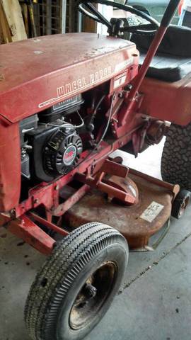

WheelHorseJunkie71 2 #13 Posted October 2, 2013 Well finally got back out to the folks place where I keep the mower at. Here's some pic's. Share this post Link to post Share on other sites

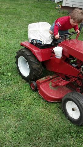

slammer302 2,157 #14 Posted October 2, 2013 Looks like the commando 6 I just repowerd for my dad got the motor for 45$ 1 Share this post Link to post Share on other sites
WheelHorseJunkie71 2 #15 Posted October 2, 2013 Slammer302 looks nice. My Briggs replacement runs good but still thinking to return it back to the Kohler 8HP if I can. Share this post Link to post Share on other sites
slammer302 2,157 #16 Posted October 2, 2013 Nothing runs like a k181 Kohler its my favorite Share this post Link to post Share on other sites
