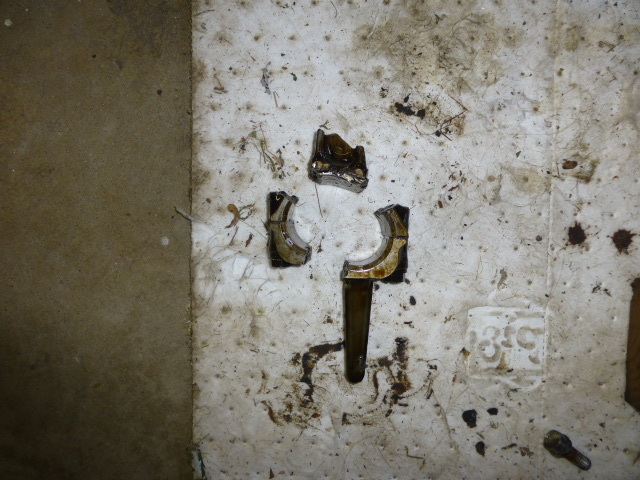

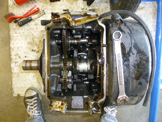

Chat6155 3 #6 Posted September 27, 2013 Thanks all! Found, downloaded and printed the manual. With a bit of common sense, I just about got it to disassemble itself down to the cam & governor. Wanted to ask before I went any further. Forddiesel69, Yep, I want to get EVERYTHING out to do a through inspection [initial oil pan removal]... Share this post Link to post Share on other sites
oldredrider 2,553 #7 Posted September 27, 2013 Yeah, that rod is toast. After complete disassembly, check that block and pan CAREFULLY for damage. Personally, I would leave the balance gears out when reassembling. Keep us posted. Share this post Link to post Share on other sites
Chat6155 3 #8 Posted September 27, 2013 Not to worry...being a novice, I've read in depth about the internals and decided early on that the balance gears, shims, spacers, clips and the pins will now reside in a coffee can hidden away in the garage somewhere. Haven't sent the block to the machine shop yet, but initial inspection doesn't reveal any damage to the block or cam. Hoping that muratic acid will clean up the crank throw enough to get a good reading on it. If no one minds, I did come up with 2 more question... 1. On both ends of the crank, where the seals ride, there is a very minor groove. I can see it, but can barely catch my fingernail on it. Could anyone with experience in this area shed some light as to weither I should worry about it or not? Share this post Link to post Share on other sites
