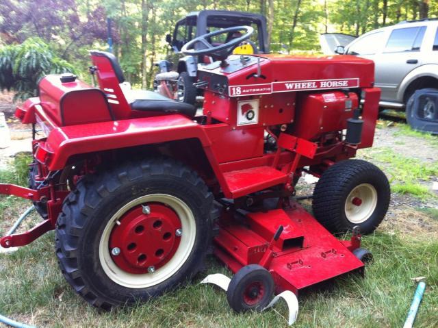

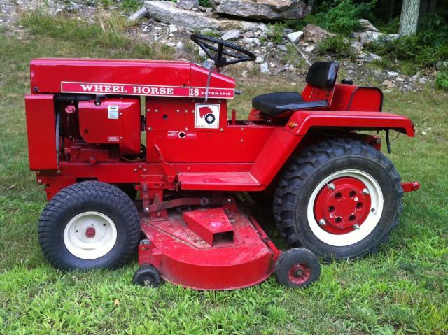

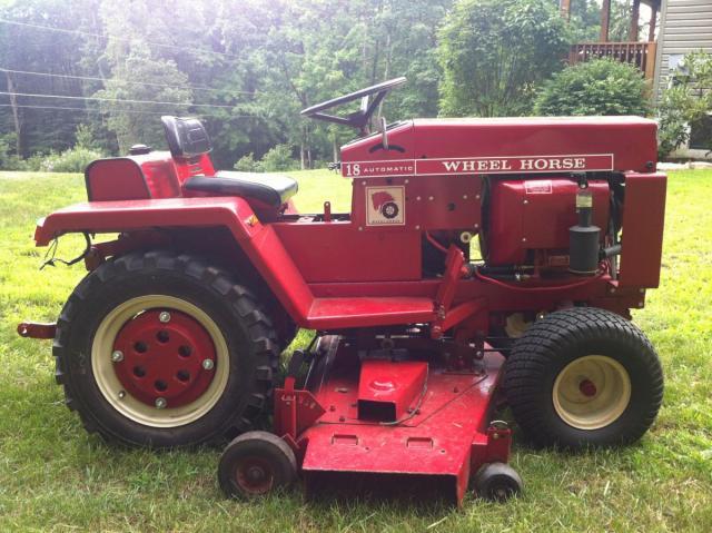

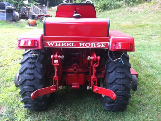

Hodge71 691 #19 Posted September 26, 2013 As far as I have been told by the WH dealers I know, the 60" deck on the 520 was a Dixie Chopper 60"deck from the Sidewinder 6024 Chain Drive. It was part of the collaboration between Wheel Horse and Dixie for the 700 series zero turns mowers that Dixie Built for South Bend. I have Dixie Manuals from 1987 and the 60 inch deck in it is the exact same deck I have for my D. Which came off a 520..... Is this 60" deck mounted under your D? Marvin Why yes Marv....Yes it is...I don't like to leave well enough alone. I take what wheel Horse did and see if I can make things better. I did it last year when I restored my 18 Auto. I bought a 60 inch deck from a member on here, bought a carriage for a D series mower and re-engineered things so to speak. I had to get a custom belt length for the PTO and I have to make a custom center lift bar but I set the gauge wheels on the deck for 3 1/2 inches and mowed all last year with it and t it all worked out in the end. I have had some engine issues with the Kohler on the 18 so i have been using the D exclusively for plowing and been mowing with my C-160 8 speed. But once I get the engine sorted out on the 18 the deck will be back under the 18 Auto 4 Share this post Link to post Share on other sites
Marv 996 #20 Posted September 27, 2013 Great looking tractor. Nice job. The front wheel looks real close to the mower. Is steering restricted? Always wondered why Wheel Horse did not have a 60" mower for the D. Guess they figured the D250 had one so the 180 and 200 didn't need one. Marvin Share this post Link to post Share on other sites

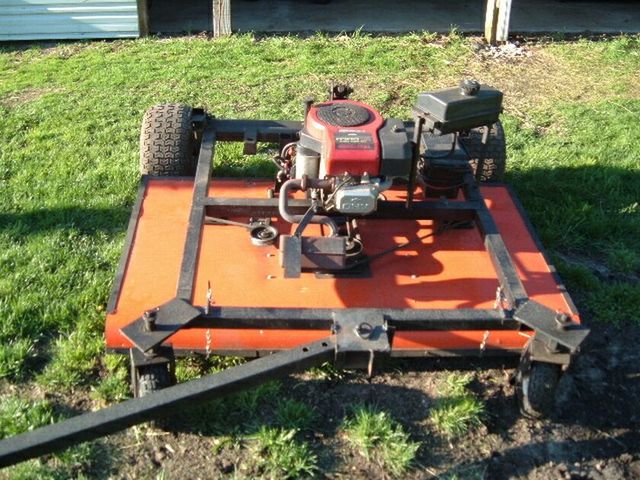

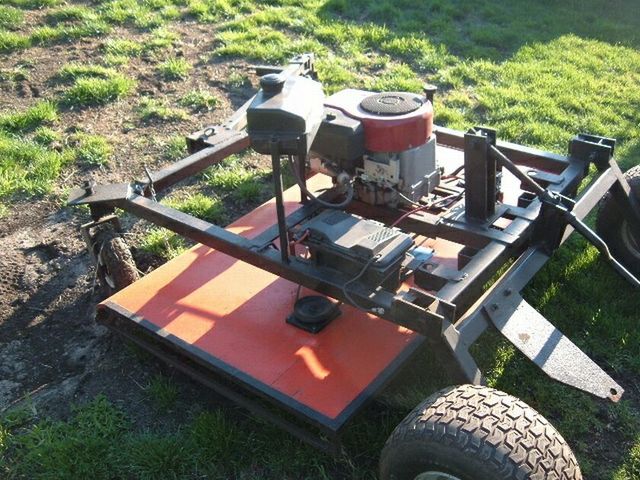

546cowboy 302 #22 Posted October 6, 2013 (edited) I have thought about doing that myself. Actually I did build a deck from scratch for a trail mower I built. I got three spindles from a friend and decided to build a 60" trail mower. I had built a 42" trail mower previously but I didn't build the deck. I used a 42" deck I had from a Cub. You have to realize that I was going to use whatever I had on hand or could get cheaply. For the deck itself my neighbor had an old truck cap for a small pick-up that had doors on each side that opened. I saw possibilities and brought it home. I cut that up so that it was the right width and depth with a saws-all, then I took some 1" angle I had and reinforced the outside edges all the way around, then I built a frame for the sides and back out of 3/4" square tubing for three sides. Then I added some 3/16" plate where I had decided to put the spindles. I cut those out with a hole saw. This cap had foam sprayed on the bottom side which I was skeptical of leaving on there but actually was a good thing. The grass does not build up on the bottom of the deck at all. This could also be caused by the fact that the deck is opened on three sides though. I used the same set-up for the rear height adjustment that I had on a bush hog at the time and the front has chains for height adjustment. Anyway I built a trail mower frame to hang the deck on and have been using it for about 6 or 7 years now. Here are a few pictures. You will notice a piece of plate at the left rear that is where I can attach a second trail mower. With a tractor with a 48" deck, this mower and another 44" trail mower I can mow a little over 12 feet at a time. Talk about cutting your mowing time. Edited October 6, 2013 by 546cowboy 1 Share this post Link to post Share on other sites
