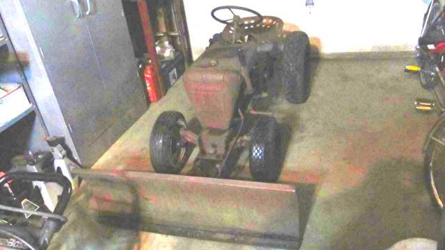

Wheel Horse Kid 104 #1 Posted September 23, 2013 Hi All, I thought I would start a thread for the 401 that I bought last week and picked up yesterday. I have been wanting a 401 for a long time and am so happy to finally be able to have one! This is my first RJ/Suburban and I already love it alot! It is a nice, orginal tractor and also came with the plow, inside wheel weights, and tire chains. Am planning to restore it this winter and hopefully will have it done by next spring. Thanks to Jim Meyer for selling me a great tractor! Here are some pics of when I unloaded the tractor today and also after I power washed it and also of it in it's new stall . I will be sure to keep you all updated on the restoration! Hope you enjoy the pics! Taylor 4 Share this post Link to post Share on other sites
welderman85 53 #2 Posted September 23, 2013 Great looking new toy 1 Share this post Link to post Share on other sites
AMC RULES 36,940 #3 Posted September 23, 2013 Humm... looks like I see some of the factory paint emerging there in that last pict. 1 Share this post Link to post Share on other sites
Mr. 856 170 #4 Posted September 23, 2013 I want an old round hood so badly. nice score and ill be following the restoration. 1 Share this post Link to post Share on other sites
Wheel Horse Kid 104 #5 Posted September 23, 2013 Thanks for the compliments guys! Craig, you are right. Some of the paint did emerge after the power washing! I was suprised how much did show up. If it did not look so bad, I would keep it original, but it does not look very good in person, so it is getting a restoration. LOL! Share this post Link to post Share on other sites

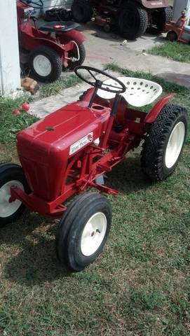

CasualObserver 3,406 #13 Posted September 24, 2013 Looks like you got a keeper. I wouldn't worry about the trans, you know there's plenty of guys here who can help you out with parts if you break something. I enjoyed using my Suburban 400 in the snow. I used it one season for the novelty and looks from the neighbors. In my experience it did great. As you can see here, it worked good in about 3-4" of light powdery stuff. I just wished I'd have put on the pedal and rope to angle the blade... it was a little annoying getting off and on just to angle it by hand. 2 Share this post Link to post Share on other sites
Wheel Horse Kid 104 #14 Posted September 24, 2013 Very Nice Suburban Jason and Thanks for the kind words/info! I think I am going to go ahead and put a different engine in mine (the one in it now has no compression and needs a rebuild) and also service the trans and make sure everything is working good and then use it this winter for plowing and do a resto next spring. BTW, How does the pedal and rope system work to angle the blade? All I have on mine is a chain that is connected to the bolt that you take out to angle the blade... Thanks, Taylor Share this post Link to post Share on other sites
CasualObserver 3,406 #15 Posted September 24, 2013 Thanks, it's one of my favorites. There is a pedal that goes on the right foot peg that the chain hooks to. When you depress the pedal, it pulls the indexing pin on the blade. The rope connects to the top outer edges of the blade. You should see either holes or S-hooks there. To angle blade, depress pedal to pull pin and then yank the rope either direction till it locks back in. Pic below is example of setup. 1 Share this post Link to post Share on other sites
CasualObserver 3,406 #16 Posted September 24, 2013 I should add one word of caution, be careful if you use it. There is not a spring trip option on this style of blade. If you hit a stationary object or a substantial driveway crack, or something straight on... you will stop.... and hard! 1 Share this post Link to post Share on other sites
