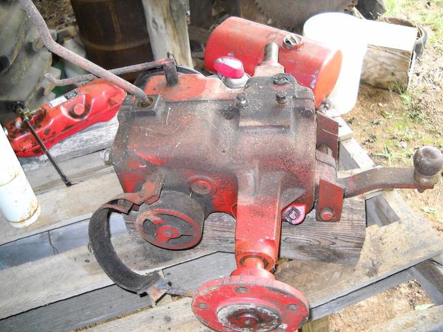

huggybear 0 #1 Posted September 17, 2013 Hello, I have a transaxle that I need help identifying, I bought this from a local scrap yard, I seen it and couldn't leave it. Info. Uni-drive Pat. No. 2988185 High - Low shifter 1,2,3 and reverse I have a use in mind for it but I am sure I will have to tear down and replace seals and bearings as i have noticed the seals leaking. If anyone has infomation about this transaxle ( model number so I can find out replacement parts numbers ) or info on what WheelHorse it could have came off of, it will be greatly appreciated. Share this post Link to post Share on other sites
Duff 206 #2 Posted September 17, 2013 (edited) Hello, I have a transaxle that I need help identifying, I bought this from a local scrap yard, I seen it and couldn't leave it. Info. Uni-drive Pat. No. 2988185 High - Low shifter 1,2,3 and reverse I have a use in mind for it but I am sure I will have to tear down and replace seals and bearings as i have noticed the seals leaking. If anyone has infomation about this transaxle ( model number so I can find out replacement parts numbers ) or info on what WheelHorse it could have came off of, it will be greatly appreciated. Hi, huggybear, and ! Lots of useful info to be had here! On a first look. that appears to be the tranny used in a whole range of Wheel Horse tractors and fortunately the parts are quite interchangeable. Before you do anything, do the parts turn freely? Did you try to drain any oil out of it, and if so what color was the fluid and/or was there any water mixed in? Actually, since its's not realy a difficult job I might recommend splitting the tranny case and looking things over to see just what, if anything, may be torn up inside. There are some excellent threads here on how to tear down and rebuild these trannies, and because of their ruggedness it's often a very good investment. Let us know what you find! Duff Edited September 17, 2013 by Duff Share this post Link to post Share on other sites
Ed Kennell 35,770 #3 Posted September 17, 2013 WH made a lot of 8 speeds 5073,5086,5091,103916. It looks like the 103916 that is in my 1978 C-101 Share this post Link to post Share on other sites

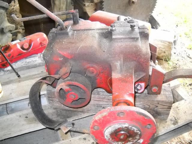

Ed Kennell 35,770 #4 Posted September 17, 2013 I see some casting #'s on the drive (right side) on your pic. These #'s on my 103916 are 8163 9010 no 1. On the brake side they are 7883 941. Share this post Link to post Share on other sites
stevasaurus 22,230 #5 Posted September 18, 2013 Definitely an 8 speed (vise a 6 speed)...the brake drum is on the cluster gear shaft. The casting numbers really will not tell you much (if anything) about the transmission. What will help to tell what it really is you have there is inside the differential...ie, how many pinion gears, what the axle gears look like, etc. Measure the axle diameter...it is either 1" or 1 1/8"...that will eliminate a couple of transmissions. As was stated above, your transmission will fit most (if not all) of the 8 speed Wheel Horse tractors from 1970 and up. Share this post Link to post Share on other sites

rmaynard 14,897 #7 Posted October 10, 2013 Looks like there is the remnants of a dipstick tube showing on the right rear corner. That is also a clue. Share this post Link to post Share on other sites
stevasaurus 22,230 #8 Posted October 10, 2013 The 4 seals you need will run around $12 from Motion Industries. The gasket between the trans halves is around $6 from TORO.. The needle bearings run from $4 to $7 apiece from Motion Industries. Figure around $70 to 80 total. This figure does not include replacing the #1533 ball bearings, or replacing any gears or transmission halves. (any of this would be used parts from members on Red Square) The job is not hard to do and can be done with a few basic tools and punches. How to threads and videos exist here on the site. Let us know if you have any questions. 1 Share this post Link to post Share on other sites
