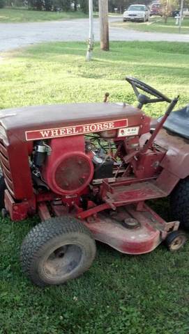

shlitzcan 2 #1 Posted September 16, 2013 What is the best way to go dollar amount/torque to build up my 8 h for an amount that wont piss my wife off..... my neihbbor does machine work cheep for me and ots quality work. Money would be parts. Its going back into my all original 1965 855 and its gonna be my tractor that i need to rely on for everything. Help me out guys... Share this post Link to post Share on other sites

shlitzcan 2 #4 Posted September 18, 2013 I have an 854 that has the same series 181 and a few times it has left me looking for help from the neighbor to get it done, but its just by a hair. Basically i would be looking for more torque. Share this post Link to post Share on other sites
