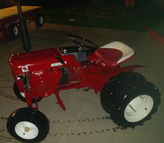

shlitzcan 2 #1 Posted September 16, 2013 So I broke my fuel pump (aftermarket) and ordered a new one. Since I did so I figured I would put a new kit in the carb. The one i received was basic that replaced the old needle under the float and a gasket. I received the new fuel pump which is now all plastic with a metal arm?? and I have not had this 8 horse ever run like this. EVER> biggest issue is its pumping fuel right out the front of the carb. Can't get it to stop. I have taken the thing off several times to see what is going on and it appears that the float and needle are functioning properly when the carb is off. The float is not leaking and is dry inside, and it starts right up every time, but then it just suffocates with fuel. Also, I can't get the bowl to seal for the LIFE OF ME!!!! I have owned this horse for quite a few years, High compression rebuild port polish and has balls the size of Texas. But not so much right now. ' Help!! (i'm having withdrawls from driving this thing) 2 Share this post Link to post Share on other sites
