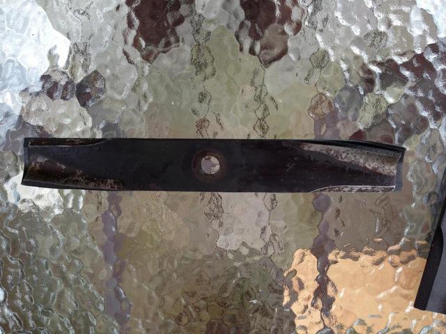

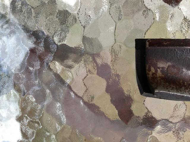

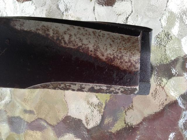

Hodge71 691 #32 Posted September 16, 2013 (edited) Ok guys so I tore into it this morning and found lots of little issues but the big issue was definitely the wrong blades. I found that this deck has been welded on before. There are about 4- 6 welds (Ok maybe it was bubble gum stuck to the deck, at least they looked like bubble gum) of various degrees radiating from under the rear deck hanger bolts. I guess maybe it spider cracked at one time or another. Those bolts were loose so I tightened them. I found the right hand hanger bar worn pretty well so I will be making or buying a new one over the winter. I replaced the deck belt and blades. Heres a comparison of the blades I was told were 42 RD blades VS the correct 42 RD blades from my Toro dealer. As you can plainly see the original Ebay blades were definitely wrong. I never second guessed anything because the Gator blades were the same size. Shame on me for not checking further I guess. I ripped off a couple passes and it mows 95% better. Not as good as the 60 incher I have on the 18 Auto but that tractor doesn't run worth poop right now so this'll do for this year I guess. I think this winter is going to involve tearing this deck completely apart grinding off the bubble gum welds rewelding all the appropriate areas correctly and making it perfect. I will also be finding some 3/8 cold rolled round stock and bending and welding it in place from one end of the deck to the other in the front. Similar to what they did in later side discharge models. Topped off with fresh coat of paint top and bottom and some new wheels and anti scalp rollers. I bet it will last another 40 years easy!!! Edited September 16, 2013 by hodge71 1 Share this post Link to post Share on other sites
