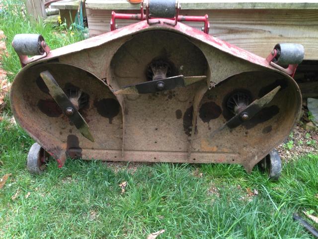

Hodge71 691 #1 Posted September 11, 2013 I bought a rear discharge deck a couple months ago. Some may remember that it had these crazy baffles in it that everyone swears aren't factory. I was told by a bunch of people to cut them out, so I did. I now have found at least 4 decks with these baffles and a few that dont have them. Well I never cut the grass with them in so I have nothing to compare this to other than a side discharge deck but I have noticed that this thing cuts like poo.. It stripes the lawn with 3 high spots like the blades are jacked up. I have tried new gator blades, new factory Toro blades at the tune of $75, both sets at the same time and found that no matter what it still skips and the yard looks like an MTD cut it. I have tried mowing twice, even 3 times in different directions and it still leaves the high spots. The deck is dead quiet, actually the quietest deck I've owned, the blades are sharp, I have checked them for level on the deck itself and they are, they are also tight to 75 ft pounds and don't slip on the spindles, yet it still skips right in the center of all 3 cuts with the center blade being the worst. I have no idea what could be causing this. I have cut with the deck on my 416 and my c-160 and it makes no difference, so I have eliminated the tractor as the cause. Maybe making new baffles would fix it? But why would some 42" RD decks not have them and cut fine? I'm baffled, so to speak....or maybe I'm not Anywho..... any ideas where to look? Frustration is setting in.... I was told that these decks cut better than any WH deck but I'm doubting big time. Share this post Link to post Share on other sites

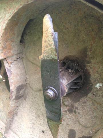

Lane Ranger 12,149 #5 Posted September 11, 2013 The blades sure look short in the photo. It looks like they have been sharpened beyond normal life of cutting. Share this post Link to post Share on other sites
MaineDad 87 #6 Posted September 11, 2013 Is the tension pulley on the deck tight? Have you adjusted the level of the deck so the front is just slightly lower than the back? I have used a RD deck with no baffles for years and it cuts beautifully. In fact my neighbor always comments on what a nice job my mowing deck does. I'm with Lawn Ranger, those blades looks very short and deformed. Share this post Link to post Share on other sites
C-160 Auto 10 #7 Posted September 11, 2013 He said he has new blades and took the baffle out? Maybe those are pics of before? It stripes the lawn with 3 high spots like the blades are jacked up. I have tried new gator blades, new factory Toro blades at the tune of $75, both sets at the same time and found that no matter what it still skips and the yard looks like an MTD cut it. Share this post Link to post Share on other sites

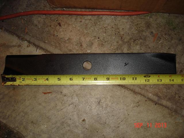

Hodge71 691 #8 Posted September 11, 2013 Those are not the blades on the deck now. They are what was on there from the PO. I believe he was a professional rock farmer or he felt that it was easier to sharpen the blades on the rocks than it was to pull the deck and sharpen them correctly. There is a brand new set of Toro blades that fit very close to the baffles and each other. The idler/tension pulley on the deck is fine. I do use the C-160 8 speed with this deck. I have tried to mow in every gear from third low to first and second high. The speed doesn't make a difference in cut quality. Believe me, I'm as lost here as the rest of you. Keep asking questions hopefully together we can get to the bottom of this issue. I will check the deck for level again on the tractor and make sure that the front is 1/4 inch lower than the back. Im not sure how that small increment could make this go away. It looks really bad. Share this post Link to post Share on other sites

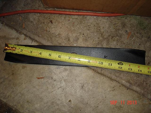

C-160 Auto 10 #20 Posted September 11, 2013 The RD blade should be 14 1/2" from blade edge to blade edge....or 14 3/8" blade edge to wing edge. (I just measured a new spare set I have) Share this post Link to post Share on other sites

Hodge71 691 #25 Posted September 12, 2013 (edited) Well there was some progress today. I did a little research this morning and found that the Gator blades are definitely too short and according to the part number on the Toro blades that I have, they are for a side discharge deck. I got the box and checked the number and even though I ordered RD blades, they sent SD. stinkin internet places..... As some may know the starting issues I have been having since I rescued this thing from the butcher that thought he knew about tractors. THe solenoid finally crapped the bed so I took it off and headed to the parts store to grab another one while it was still dry here. Bought the solenoid, took it home and put it on and the darn thing continues to try to start even after I turn the key off. I check the wiring and its exactly as the factory diagram says so I take it off and back to Advance Auto Parts for another one. 15 Mile round trip and a half hour after getting home The "NEW" one is installed, I check the wiring, hit the key and click......nothing..... OK get the meter out, 13.3 volts into the solenoid and .5 volts out with the key on start.... Now I'm a bit peeved at Advance for selling Taiwan ROC crap so another trip back and forth for Solenoid #3. This one does exactly like #1....tries to start even with the key off. I give up....took it back and got my 22 bucks back and went off to Ringtown Farm Equipment for my correct blades and a brandy new deck belt as this one has a few cracks, nothing I believe that is causing this issue but Moparfanforever said that it fixed his issue. I ask if she has a solenoid on the shelf and by George she does. She hands me an OEM Toro parts box and inside is a brand new made in America solenoid!! It cost me 46 bucks but when I got home I put it on, wired it up, hit the key and the C-160 fires right up. Heres something you don't see everyday with parts. I So anyhow I decided that my local toro dealer is the people to deal with from now on. Enough with dealing with the internet and parts stores that sell junk. Boov..... We made it through with no damage other than lightning strike to 1 oak tee and washed out driveway. 3.3 inches of rain in 2 hours and another .6 this morning. Black and ominous now so looks like we gonna get smacked again. Its raining again here unfortunately so I will be waiting until later or tomorrow to replace the blades and spindle belt. I cant wait to see what the difference is between the RD and SD blades. I'll post pics when I get them. Edited September 12, 2013 by hodge71 Share this post Link to post Share on other sites
