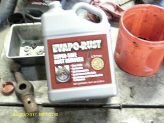

diesel cowboy
For something like that I'd try using Evapo-Rust.  I've used it on a lot of smaller stuff with good results and you can also soak a paper towel with it and put it where you need to remove the rust and cover it with plastic to keep it from evaporating.  It also says its not harmfull to other types of metals and plastics.  I get it by the gallon from Tractor Supply, but Auto Zone, Advance Auto, Harbor Freight, and several others have it also.   Stewart
