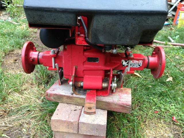

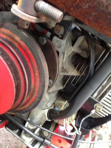

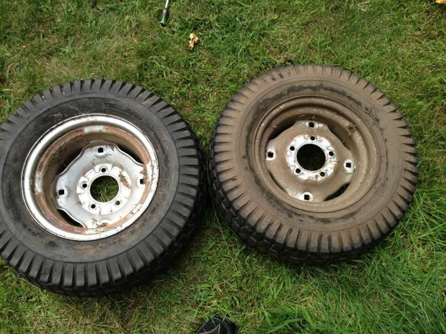

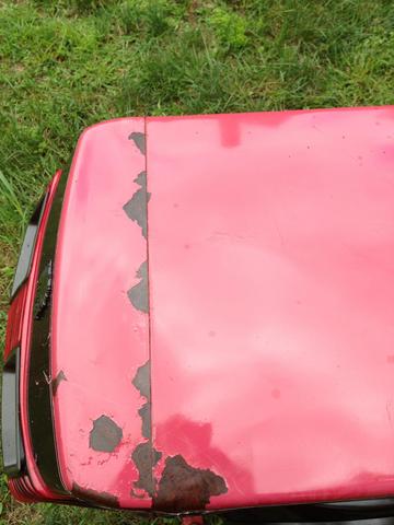

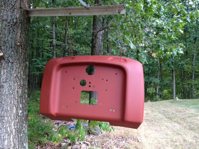

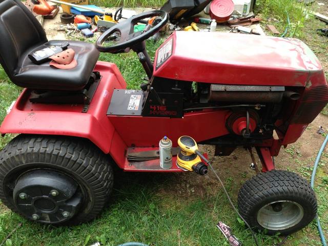

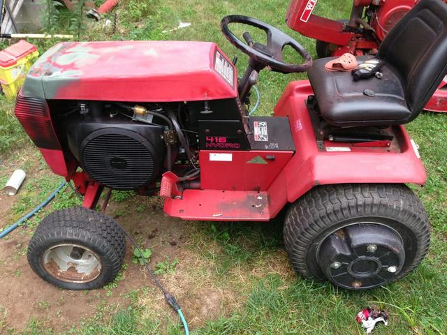

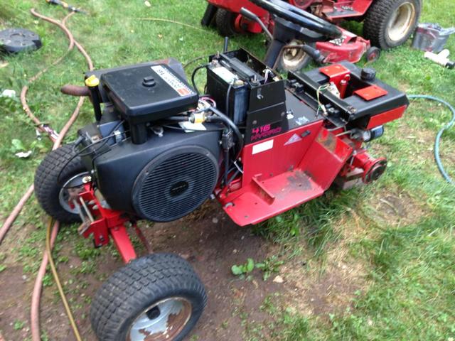

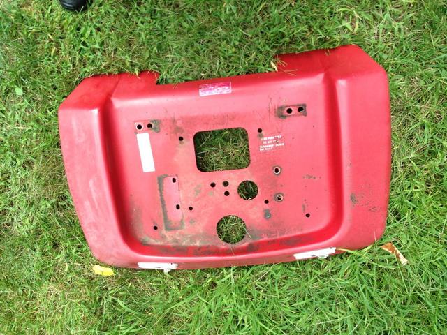

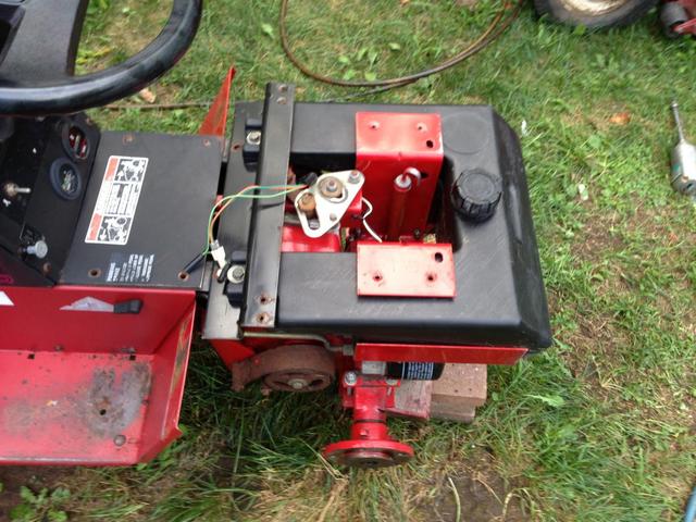

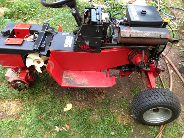

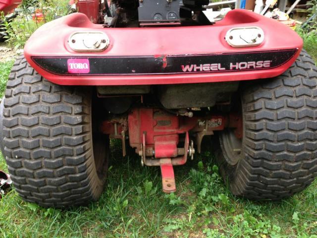

So I tried to sell it 3 times....completely frustrated that people are way too big of a cheaptskates and wont pay $400 bucks for a great running tractor so Jeb and I turned it into a Father/Son project. We started it last week with some priming and today we tore the wheels off her, hood and pans off covered it in "Purple Power" and Jeb pressure washed it from top to bottom. Heres where we are now. Guessing  priming and painting the wheels will be the first order of business as he is looking for some results. Hers some pics of before and after...I cant believ how clean it is once all the dust and dirt were blasted off of it.
I'll add more once the wheels are masked and primed.

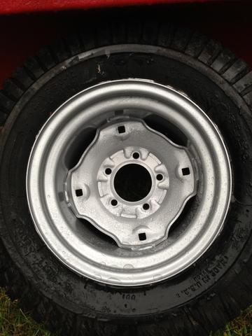

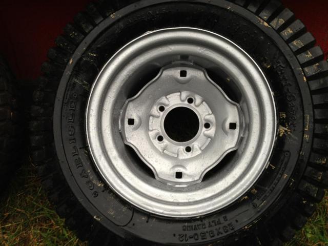

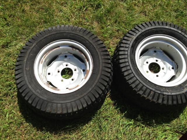

Some more done this afternoon. I love seeing the wonder in Jebs eyes as each part comes off and gets cleaned. He really has drive too so I dont thinkits going to take too long to get this done. We got one rear wheel masked off sanded, primed, and then painted with Rustoleum "Hammered Silver". It looks great but it got dark too soon to get to the other one. Tomorrow morning I'm sure he will be up bright and early to start again. Heres the after pics of it after Jeb's pressure washing job. I'm really happy with the Purple power cleaner. For a Tractor Supply generic I personally think it cleans better that big name cleaners. There isnt a drop of oil or grease anywhere on it now. Gonna be easy to prime and paint.

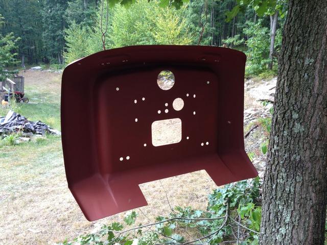

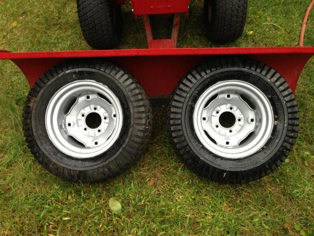

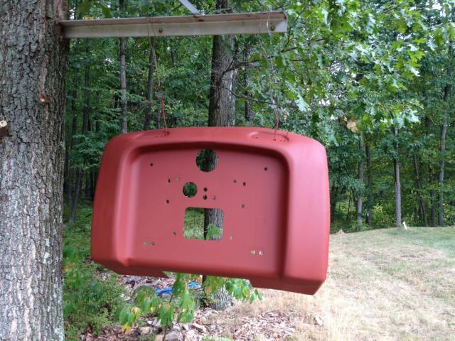

Crazy weather lately and tons of school work has impeded progress on this project a bit but We got the wheels sanded primed and repainted and yesterday got the fender pan cleaned and primed. Then the humidity kicked up and I wont paint in anything above 60% humidity. It wreaks havoc with spray bombing. So heres some pics.
post-1339-0-49278300-1379020190_thumb.jppost-1339-0-49718200-1379020283_thumb.jppost-1339-0-47916400-1379020678_thumb.jppost-1339-0-39110900-1379020690_thumb.jppost-1339-0-14318000-1379020706_thumb.jp.
Tomorrow I hope to do some wet sanding on the fenders and get a couple more coats of filler primer and maybe get some color on them. Temps in the 60s with 30% humidity is perfect painting weather
953 nut
Wish my trees had branches like that!   :text-lol:
Love to see father and son projects coming togather, lots of learning and lots of bonding. Keep up the good work. :text-goodpost:                         :text-coolphotos:

Thanks 953. That was made by me when my son was born almost 8 years ago. I worked in a food plant at the time and had access to miles of stainless. I spent many hours pushing his but in the Home Depot race car swing that used to hang from it. Now we are using it for a different type of bonding. The divorce has been pretty rough on me even after 7 years but any time we get together makes my heart smile. Tractors even make it better.

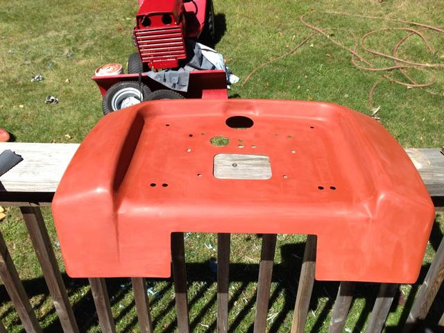

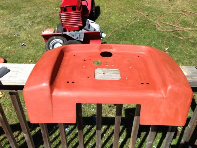

Got some more progress today. Been cold n wet for awhile so Ive been wet sanding and priming almost constantly to fill the little pits and imperfections in the paint from years of use. But today was perfect temp and humidity for spray bomb painting. I wet sanded my butt off this morning with 800 grit and I must say it was maybe the best sanding job I have done so far. I'm learning more as I do these tractors. By the time I get done I may be going back and redoing the 18 auto just because my skills have gotten better.  Here's a couple pics.
post-1339-0-44286700-1379524463_thumb.jp
post-1339-0-75018400-1379524479_thumb.jp
post-1339-0-00177600-1379524494_thumb.jp
post-1339-0-71620800-1379524506_thumb.jp
As you can see from the last couple Theres quite a bit of gloss with this paint.I know its not top shelf automotive paint like you professionals use when you redo these but I'm very impressed to say the least. It flows well as long as you keep moving. I can wait to see the gloss when dry. I'm sure it will be less but I wonder how comparable it will be to Valspar tractor and implement.

It looks pretty good and I think the shine will be pretty good. My advice, don't be tempted to clear coat it. Rustoleum can be very finicky when you add clear coat. Sometimes it wrinkles, sometimes it don't...Also remember, it might be dry to the touch but if you start too handle it too early you will leave fingerprints. It will need at least a few days and then some too fully cure. After all this I'm sure you are going to keep it!

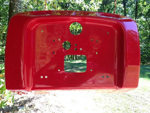

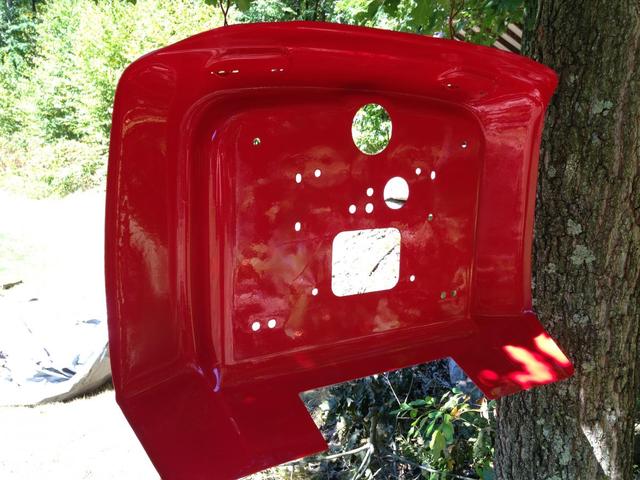

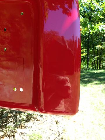

Not exactly the way I wanted to get this bumped to the top.....but the only way to learn is from failure.....I found Rustoleum clear at the local big box store and decided to shoot the seat/fender pan. I started on the bottom side so that if it screwed up I wouldn't complain too much. Well after trying the bottom and seeing that dusting it on did nothing but give me a grainy finish that looked like poop to say the least, I let it set to be sure no crazing or lifting of the red and I figured just a bit heavier on the top so it flows out........Welllllllll lets just say the top is shiny and flowed out buuuut there are about 15 runs on it and I am completely disheartened that I took a great paint job and ruined it with lack of skill. :banghead:  :banghead:  :banghead:  :banghead: SO paint guys....how can I get these runs gone without stripping and redoing everything from the beginning? Wet sanding with maybe 1000 or 2000 to get the highspots down and them buff the heck out of it to bring back the sheen to the clear? Ideas....anyone....anyone? :confusion-helpsos:
jaebo74
If you're as impetuous as I am, you might as well just strip it and redo the paint job. The spray bomb paint will take a while(maybe a week to a month) to be hard enough to sand out.
Edited by jaebo74
