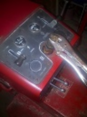

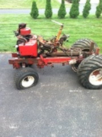

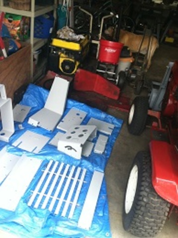

Hi Guys,
I picked up a running D180 froma guy in New York about 6 months ago now. He used it as a tractor and made every modification he felt like. Stupid lights, cut the original steering wheel off with a cutting torch, destroyed the seat mounting system and cut a large chunk out of the frame. it had a horrible off color paint job, but at least it kept away the rust. It came with a HUGE snowblower and a Huge plow. he claims the snowblower works, just needed to be hooked up. so about 4 months ago I tore her all the way down to the frame, and of course more problems. the guy had broken off 3 of the 4 exaust bolts, had the wrong spark plugs in, messed with the hydro controls, and made the largest rats nest of a wiring job I have ever seen. so I went to work. I got all the parts off, and to the sandblaster. Then the parts were primed by me, and brought to a buddy of mine who paints automotive for a living. finaly, all the parts are back, painted and on the tractor. everything the PO mucked up is fixed, and nearly ready to run.
