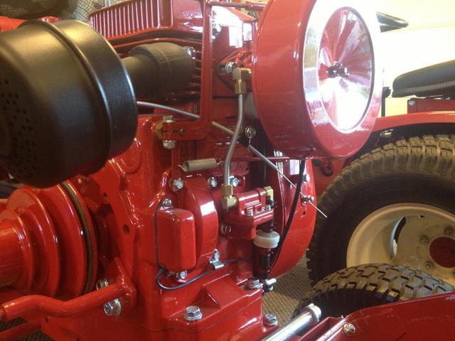

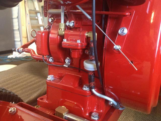

Martin 2,134 #2 Posted September 2, 2013 welcome to red square..... first of all heres how the fuel system should look.... line comes from the tank to one side of the pump, and from the other side of the pump to the carb..... (this is my 1057, i have a 1054 as well but this one was easier to get two pics of because the hood opens, wereas the 1054 as you would know has that big heavy grill in the way) let us know first if you have a pump on the engine and the lines run through it. then it can be diagnosed from there...... 1 Share this post Link to post Share on other sites
953 nut 69,351 #3 Posted September 2, 2013 (edited) If your fuel pump is the original type pump it is driven from the cam shaft and it will have a primer lever coming out of the bottom of it. Unscrew the fuel line to the carb and pump the primer lever a few times. If the pump is working you will have fuel coming out. Let us know how you come out with this or any other concerns you have. Edited September 2, 2013 by 953 nut Share this post Link to post Share on other sites
Lagersolut 802 #4 Posted September 2, 2013 That's the first one I've seen done with steel line and compression fittings .....looks nice I had to replace my original pump ( after my rebuild ) because it was leaking oil out of the cam lever pin ....not just a little seep either . When I get time I'll take it to a machine shop and see if they can do an oversize pin and get it sealed. Share this post Link to post Share on other sites

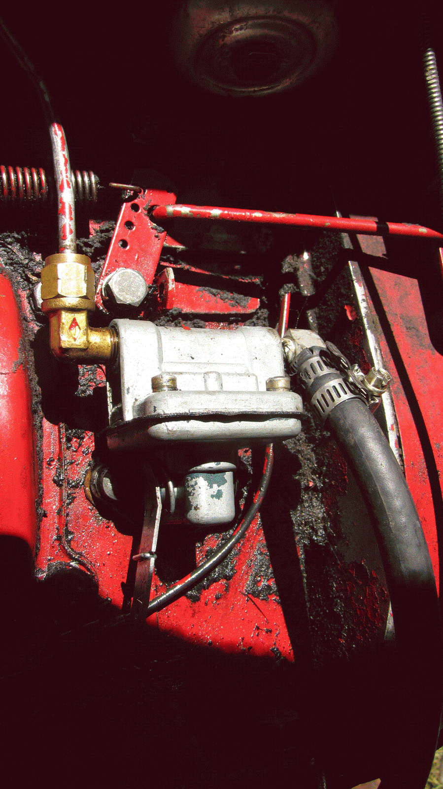

wheelhorsearound 6 #8 Posted September 4, 2013 Finally got the photo to upload, seems I just had to lower the quality. Might help?! Thanks again. 1 Share this post Link to post Share on other sites
953 nut 69,351 #9 Posted September 4, 2013 The inlet and outlet of the pump have little check valves built in, if they have junk in them where they can't close you will not be able to build pressure. Take the pump apart and put all the parts in denatured alcohol to clean up any old gas deposits and junk. That may cure the problem, if not you may need a new pump. The one you have is great because of the primer lever. Hope this is a . Share this post Link to post Share on other sites

Wheel-N-It 2,978 #16 Posted September 12, 2013 welcome to red square..... first of all heres how the fuel system should look.... line comes from the tank to one side of the pump, and from the other side of the pump to the carb..... IMG_2297.JPG IMG_2298.JPG (this is my 1057, i have a 1054 as well but this one was easier to get two pics of because the hood opens, wereas the 1054 as you would know has that big heavy grill in the way) let us know first if you have a pump on the engine and the lines run through it. then it can be diagnosed from there...... Hey Martin, those are the best looking Kohler fuel systems I've ever seen!!! Share this post Link to post Share on other sites
