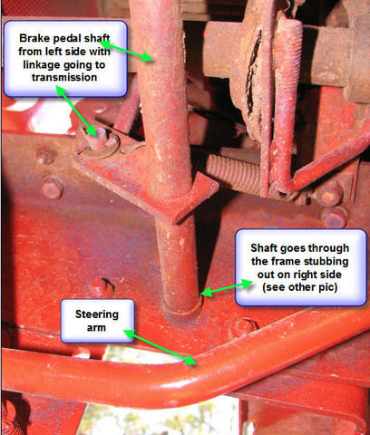

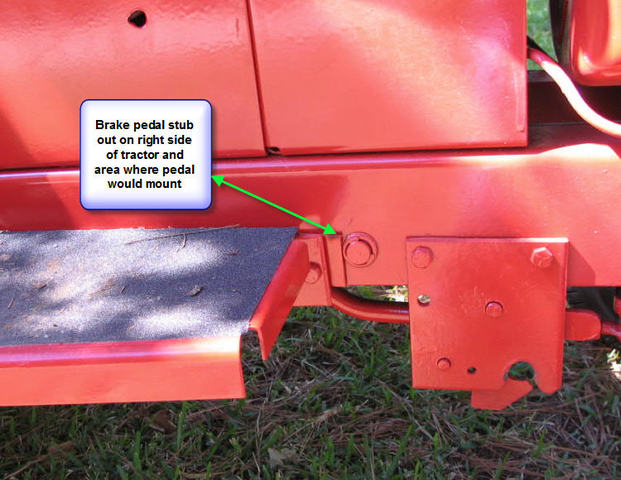

pacer 3,180 #14 Posted September 27, 2013 Am following this with interest and thought I would contribute what I could ... On my 1975 model D-180 there is nothing whatsoever on the right side to indicate there is existing means for mounting for a pedal. The "brake" pedal on the lefts shaft goes through the frame and stubs out on the right just in front of the foot rest. I should point out here that it is not a brake in the conventional sense, it has a arm attached to the transmission and simply disengages the fwd/rev lever on the column - but it will most certainly "brake" I cant remember when I utilized the pedal, I simply use the lever on the column. So (at least as far as I would care) using the existing brake shaft and re-connecting the linkage to work the fwd/rev and just not have a "brake" pedal would be OK. However that still leaves the mounting of a pedal, either on the right - which would appear to require weldments - or just use the existing pedal on the left, adapting some sort of heel piece --- or?... any other ideas? Removing the panels on a D are a pain in the back side - maybe if someone has theirs down for paint of something and could get a pic of the linkage. Share this post Link to post Share on other sites
