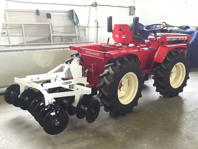

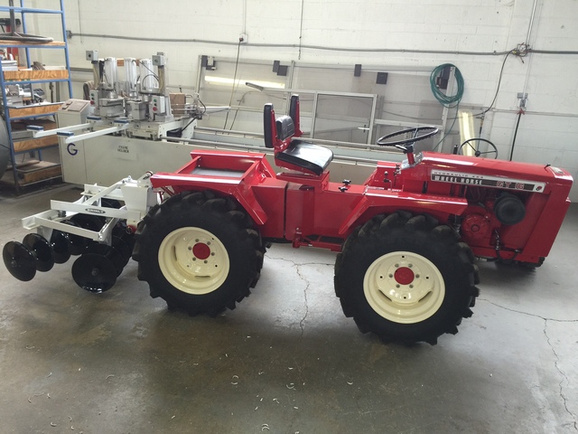

Brrly1 1,146 #25 Posted May 29, 2015 Some how, some way I ended up here. What the heck, going to add one that's only been seen on Junkies! 5 Share this post Link to post Share on other sites
